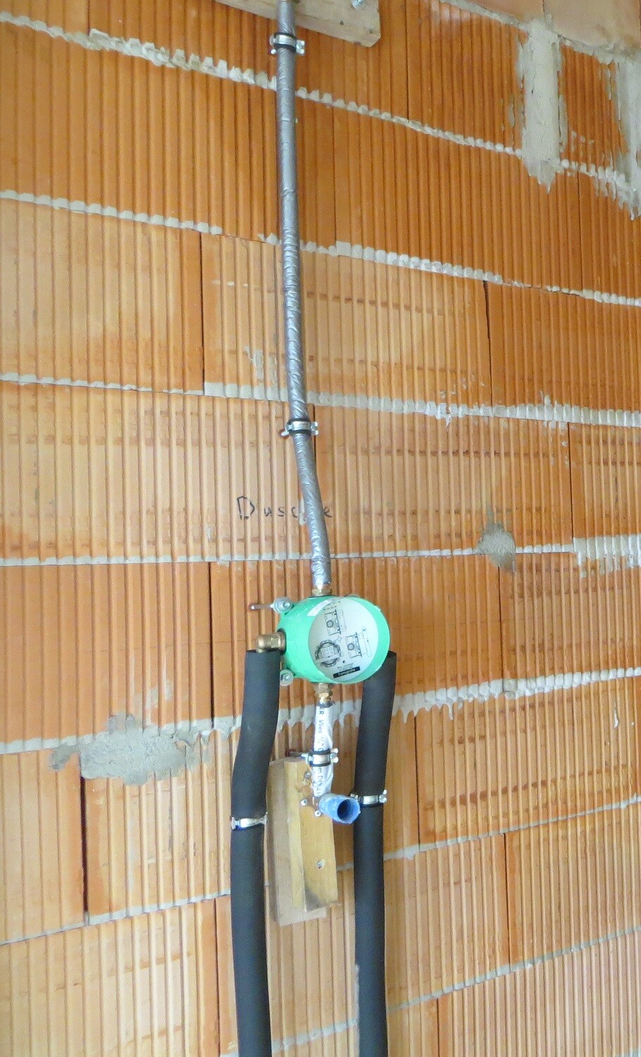

Looking at this, all my alarm bells would have gone off.

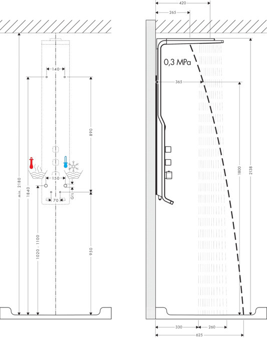

Unfortunately, this design is very poorly planned. I suspect that mounting holes above the connections would have been much less problematic.
But now it’s too late to complain—let this be a lesson for you. I hope you don’t have a guest bathroom with the same panel 🙂
This has nothing to do with building cheaply; it is standard practice and has basically always been done this way, even 30 years ago. However, the shower panel is actually extremely poorly designed. The designer really should be reprimanded for planning the drill holes like that.

Normally, I would expect the pipes to be installed vertically; at least that was always the case in older apartments. But that’s exactly the problem with today’s house construction—fast and cheap, with inexpensive labor or workers who don’t feel like chasing two chases. Unfortunately, I couldn’t take any pictures because I took over the house as a turnkey project from the developer. The shower panel we wanted to install is from Hans Grohe, and the holes are just below the outlets.No, normally you can’t assume that...what was done 20, 30, or 40 years ago no longer matters nowadays...
And before drilling anywhere, you need to determine where the pipes run; that is standard practice...otherwise, you shouldn’t drill at all.
This has nothing to do with motivation...they do what was ordered...if the order was for water in the shower, then there is water in the shower...according to current technology, that means in one chase.

QlriPower1 Oct 2016 00:34In the past, during the steel pipe era, it was done differently simply because there was no other way. The pipe couldn’t be bent like that.
However, I think it’s unfair to blame the installer for this now. You should have informed yourself beforehand about how this is done nowadays or had it done properly like everything else.
