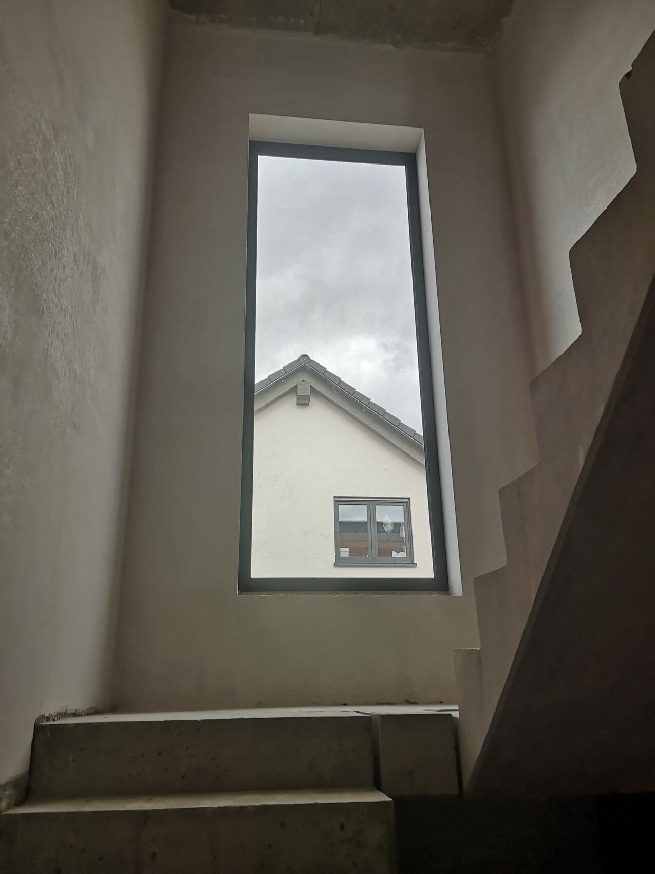

It concerns a gallery window with a rough opening size of 201cm (79 inches) width and 213.5cm (84 inches) height.
The window is fixed glazing.
He claims that he cannot supply the window as a single piece, but only in two parts.
He justified this by referring to a standard, stating that a window can only be deflected by 8mm (0.3 inches) if wind pressure is applied, and so on.
Is this all correct? Or does he simply not want to install such a large (and possibly heavy) window?

Our largest single-piece fixed-pane window measures 3.52 x 2.53 m (11.5 x 8.3 ft). It is located on the side facing away from the street, towards the slope, and the glass alone weighs over 400 kg (880 lbs). We will take out a very comprehensive glass insurance, as this massive pane can only be installed using a mobile crane from the street, which is 30 m (98 ft) away.
You can see that several factors influence window planning, including the altitude of your house above sea level. This somehow relates to the filling between the glass panes, according to our window manufacturer.
These are all aspects that can usually be addressed with an additional charge, in my opinion.
