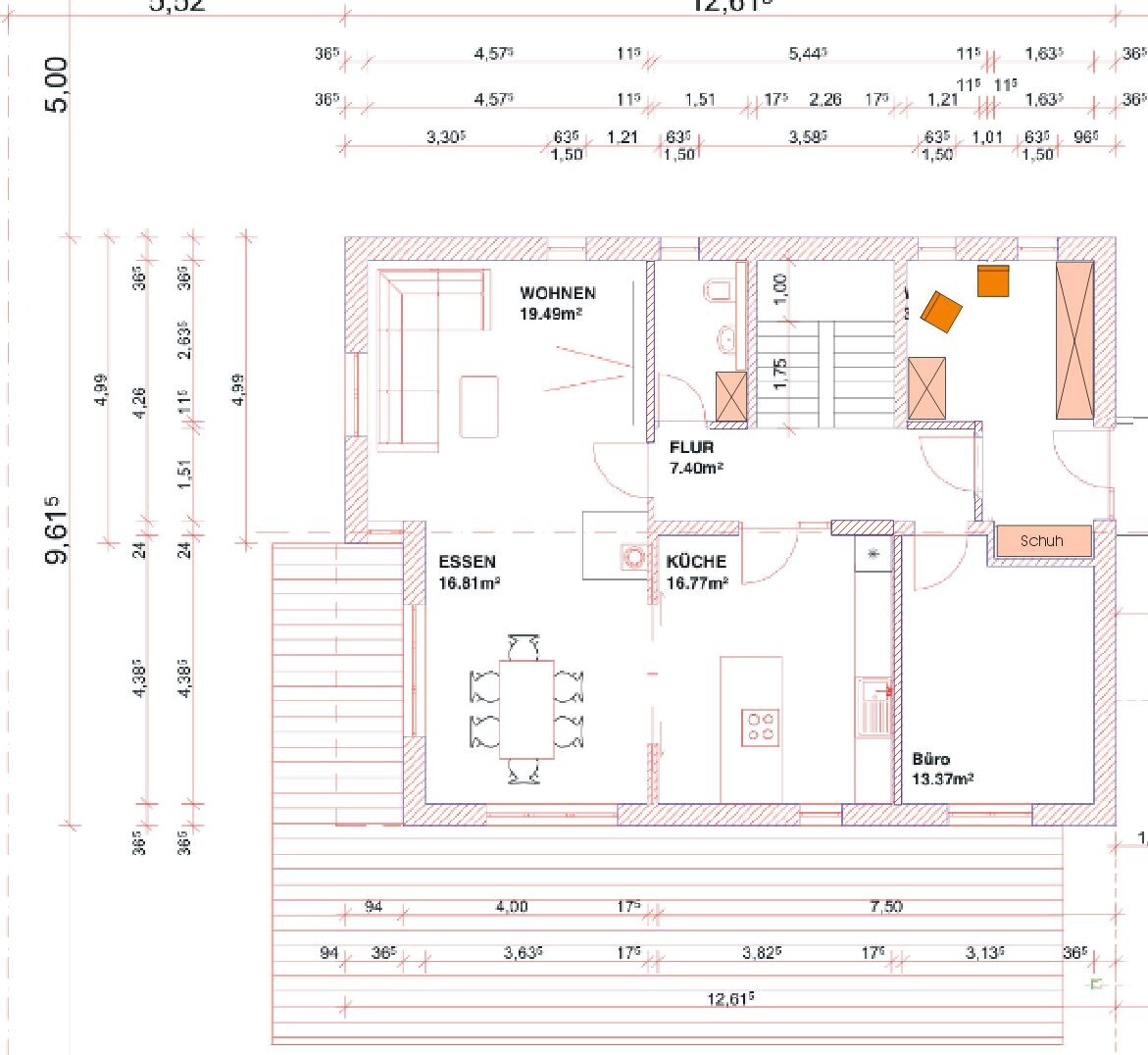

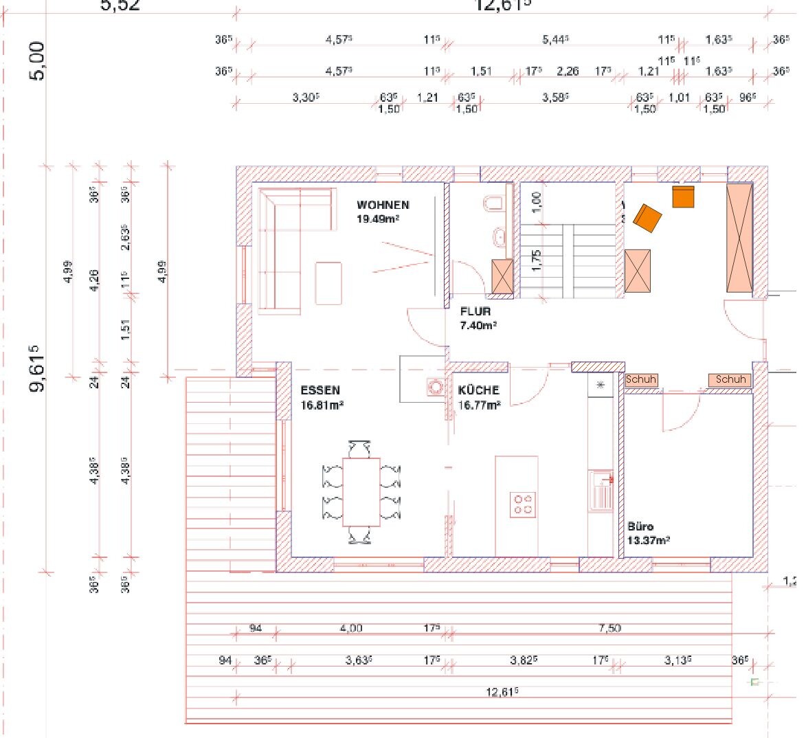

j.bautsch18 Aug 2016 14:02I definitely want the dirt area to be separated because I don’t want to walk through a snow puddle with gravel on my cozy socks in winter when I go to the bathroom or the home office. But I guess everyone is different. I know my husband doesn’t care much about cleanliness and order (he leaves things lying around, etc.), so if everyone keeps things tidy, it could work. However, I don’t want to always be the one cleaning up after everyone.
You do have a basement, right? Another option could be to skip the pantry, since I don’t really see space for a shoe collection and seating area in the currently planned entrance hall. Could you sketch that out?
In the kitchen, a fridge with a small freezer compartment for the essentials, and a proper freezer and storage in the basement.
Move the guest toilet into the pantry, then there should still be room for a closet about 80 cm (31 inches) wide to store vacuum cleaners and similar items. It can be designed to look stylish.
That way, you can have a truly spacious entrance area.
