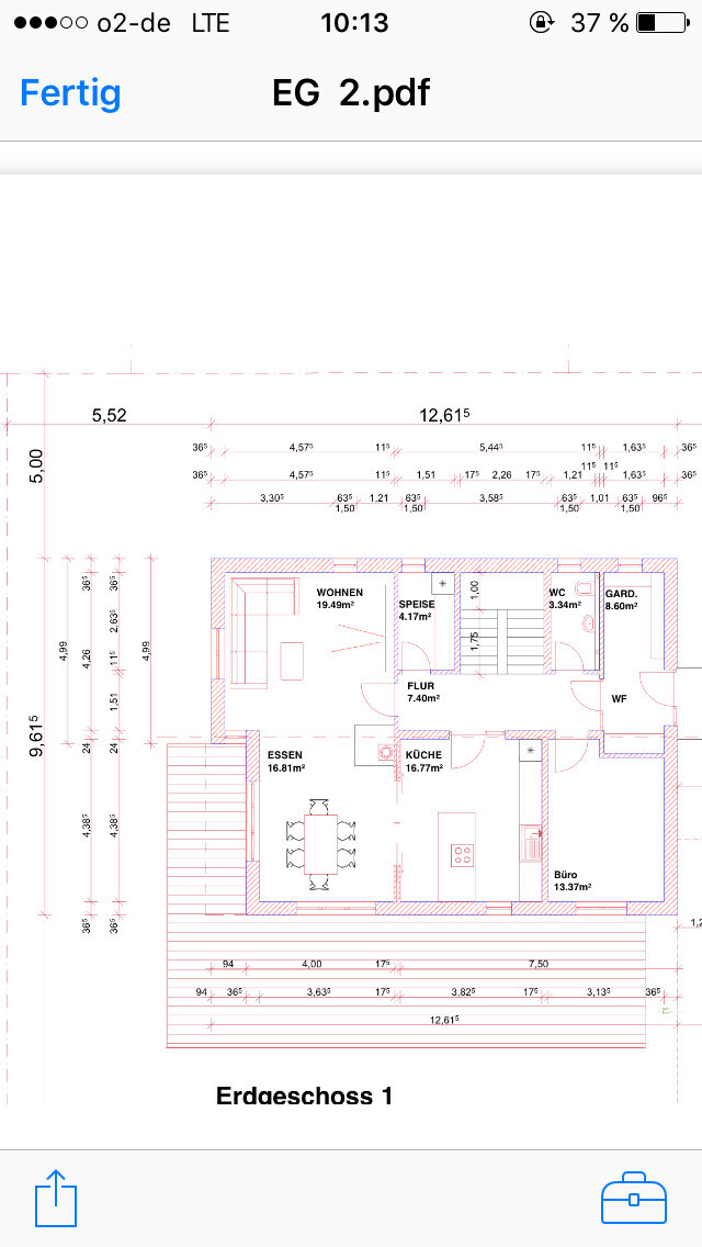

Regarding the rest of the topic, I can’t say much since we don’t have a landing staircase. But I understand your point; I would also try to avoid making the hallway too narrow if it’s that long. Would a straight staircase be an option? Or maybe just a half-turn staircase?
Could you share the staircase or floor plan? Then it would definitely be easier to help and possibly identify more optimization potential.
https://www.hausbau-forum.de/threads/Meinung-zum-hausentwurf.15775/page-5#post-135203
For better understanding, here is the ground floor plan. Please focus on the staircase.

A straight staircase is not an option for us because the basement access would then be on the opposite side, and in my opinion, an L-shaped staircase is ruled out due to our room design combined with the development plan requirements... the smallest "compromise" would be to adjust the staircase itself with only a 25cm (10 inches) tread and a landing of 90cm (35 inches), or to let the steps extend into the hallway...

Hello Maria
I have the last stair tread protruding into the hallway. But the hallway is over 200cm (79 inches) wide, so that doesn’t help you much.
Can’t you make the kitchen a little less deep (20cm (8 inches)) and turn the niche (on the left at the entrance) into a continuous space instead of a niche? That would definitely enlarge the hallway. The kitchen and the study would become smaller, but the hallway wouldn’t be such a narrow corridor anymore.
Steven
