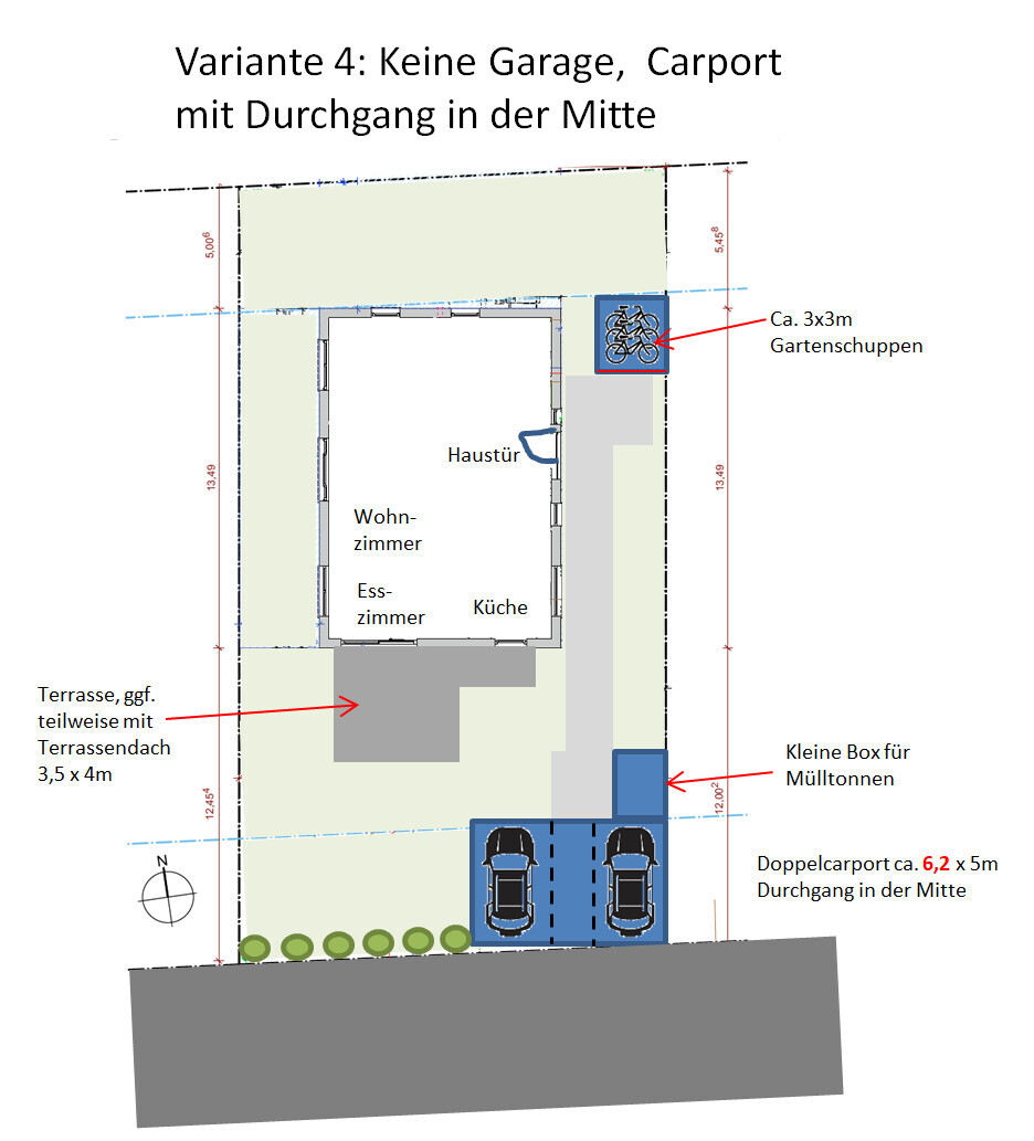

Thanks. What do you have in mind? I would tend to position the garage facing the street, with the house behind it.
Exactly like that, so set forward. Then have the passage to the left of the garage/carport. Entrance on the east side.
This also creates a cozy garden with nice west and south exposure. In winter, light will come through large south-facing windows.
You will never lose usable space, because even 3 or 5 meters (10 or 16 feet) can be nicely landscaped. Every corner can be put to good use.

Oetzberger23 Jul 2021 09:08Living room facing southwest, entrance on the east. And don’t forget the shaded seating area in the north.
ChristophG23 Jul 2021 09:45Oetzberger schrieb:
Living room in the southwest, entrance in the east. And don’t forget the shaded seating area in the north.Thanks.
Yes, that’s roughly how we had sketched it on paper as well.

Oetzberger23 Jul 2021 09:58Here are a few examples. The guest room/office is located in the northwest for us. These are older plans we had, and we were allowed to build a double carport directly by the street, with a bike storage garage behind it. But just imagine the garages and parking spaces adjusted to fit your zoning or development plan. The plot is 17 x 31 meters (56 x 102 feet), so you can even plan it one meter (3 feet) wider, which makes things a bit easier.
O
Oetzberger23 Jul 2021 10:47By the way, we went with option 1, featuring a 7 x 5 m (23 x 16 ft) carport with a passageway in the middle, a 3 x 5.5 m (10 x 18 ft) bike garage, and a nearly 3 x 3 m (10 x 10 ft) Biohort Highline garden shed. Now we have plenty of outdoor storage space.
