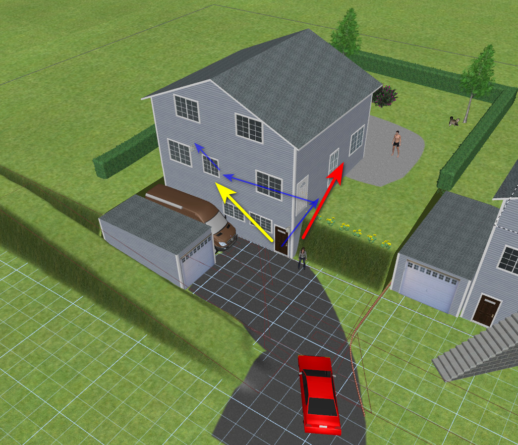

topsurfer11 Jan 2022 10:05Thank you for all the constructive feedback!
We have already drawn in the furniture, so that should be fine.
And don’t forget, this is for 2 people, not a family, no parties!
We would prefer more space, but the plot (beautiful location about 1km (0.6 miles) from a nice town center) is just like that.
I have now (again) sketched the idea of moving the parking spaces from the southwest side towards the north and planned the entrance through the basement (brown door), but:
Where to put the staircase between basement and ground floor?
- Either the yellow arrow, but then you lose the only two basement windows
- Or the red arrow, which brings you out on the ground floor in the southwest orientation where the dining/living room is supposed to be.
- Or (blue) create a hallway in the basement, but then you have to walk 5m (16 feet) straight in the basement hallway, 5m (16 feet) long to the left, before reaching the stairs. I don’t find that comfortable or inviting, do you?
Any other ideas on how to place the garage and carport and arrange the house entrance (through the basement or the ground floor)?
(An advantage of the parking spaces on the “north” side (this sketch) would be that the house could be a bit wider...)
It is known that you are planning for 2 people. Your requirement according to the questionnaire is 6 dining places, sometimes even 10. The plan shows a cozy 4, with a counter for 6. Even for 2 people, the ground floor is overloaded, and upstairs there is space left empty. To me, the house does not seem designed for you but rather like a standard family house that has been modified somehow.
topsurfer schrieb:
Therefore, according to two independent architects, a basement makes sense here. I also have no objection to the basement. I would just build it as a livable space and skip the upper floor. In the end, that will be more cost-effective.
Your new example: why do you draw soil in the southwest where there is none? Use the plot as it actually is. Your house divides it into different levels anyway…
topsurfer schrieb:
And don’t forget, it’s for 2 people, not a family, no parties! When it comes to circulation areas and furniture layout, it doesn’t matter whether there are 2 or 10 people: even one person wants to be able to use the bathroom comfortably without squeezing through. A patio door also needs to be practically accessible for a single person.
