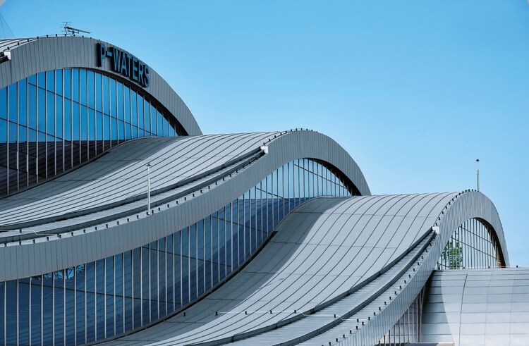

The surfaces are curved in only one direction. Bending sheet metal in one direction is not difficult. There is no need for any "forming" or shaping. (The picture shows a slightly larger example.) I am not yet sure how the edges will be finished, where the rainwater should drip off, but there are craft-based solutions for that...

In the roof covering shown in the picture, the metal sheets are surely rounded, causing the standing seams to be stretched and compressed.
Installing a standing seam roof on your curved canopy is quite a challenge. You also need to ensure that the water can drain freely without obstruction.

The seams are "stretched and compressed," yes, but these are only small sections each time and a "normal" situation for a roofer. Especially with the seams, very nice patterns can emerge on such curved roof surfaces. I’m not "afraid" of that—in fact, I believe it can make the roof surface more interesting. I hope to find someone who can explain what I need to watch out for, so I can do it myself. (Basically, I am capable of that.) Let’s see...
For a "regular" roofer, this is certainly not an easy task.
It’s not just about measuring, cutting, and folding the standing seam of the panels. You also need a raised edge in the center, which then must be compressed and connected on both sides with a lap seam. On the eaves side, a metal flashing is required as well, which also needs to be stretched in order to fold over the panels.
This requires a skilled sheet metal worker. I worked in this field a long time ago.
If it weren’t so far away..........
