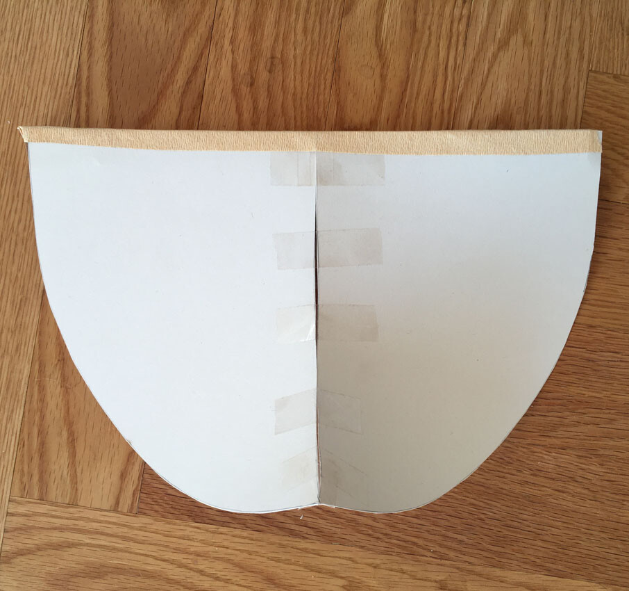

manohara18 Mar 2020 11:30
Meanwhile, I’m considering using multiple thin sheets instead of a single 3 or 4 mm (0.1 or 0.16 inch) thick sheet metal, which I can’t bend myself (because I can’t heat it up). These thinner sheets could be joined together in the desired shape.
I usually enjoy doing things myself (well, most of the time).
This experiment, however, is more ambitious than what I normally “dare” to try.
If it goes wrong, a lot of material will be wasted.
Here are two more pictures of the paper model, without the house. Maybe the shape can be seen better or differently this way.
I hope to be able to weld or solder the edges where several thin sheets lie on top of each other and are riveted together.
I think the seam in the middle would look best if welded, but in my mind it’s difficult to get the sheets close enough there to weld them properly.
An alternative would be an angled profile that tapers from 45° at one end to 0° at the other, which would then be riveted from the top as well as from the right and left.
The difficult part there is to “hit” the correct angle at the right spot.
If possible, I would also weld over the rivet points from above to prevent water from seeping in.
Well... all this now has only a slight connection to house building... but I enjoy it.
White curved paper object with tape lying on wooden floor.
White semicircular cardboard piece with central seam, tape on the seam, lying on wooden floor.
wrobel18 Mar 2020 12:37
Hello again,
If it only needs to be bent in one dimension, the process is quite straightforward.
My approach would be to have two 3mm (1/8 inch) aluminum sheets bent—there’s surely a metal fabrication workshop or sheet metal worker who can do this. You could then cut the sheets to size and prepare them for welding, create the flange for attaching to the house, have it welded, finish the weld seams and cut edges, and then have it coated.
All the stuff with wooden constructions, various substructures, multiple layers, and so on, just makes the whole thing look too heavy and bulky.
