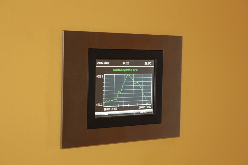

My weather station consists of a multisensor (measuring wind, twilight, rain, east-south-west light levels, DCF signal) mounted on the roof
and an indoor station that processes the data and displays it on screens inside the house. But again, there are thousands of variations of such systems.
This is roughly what the system looks like inside the house:
