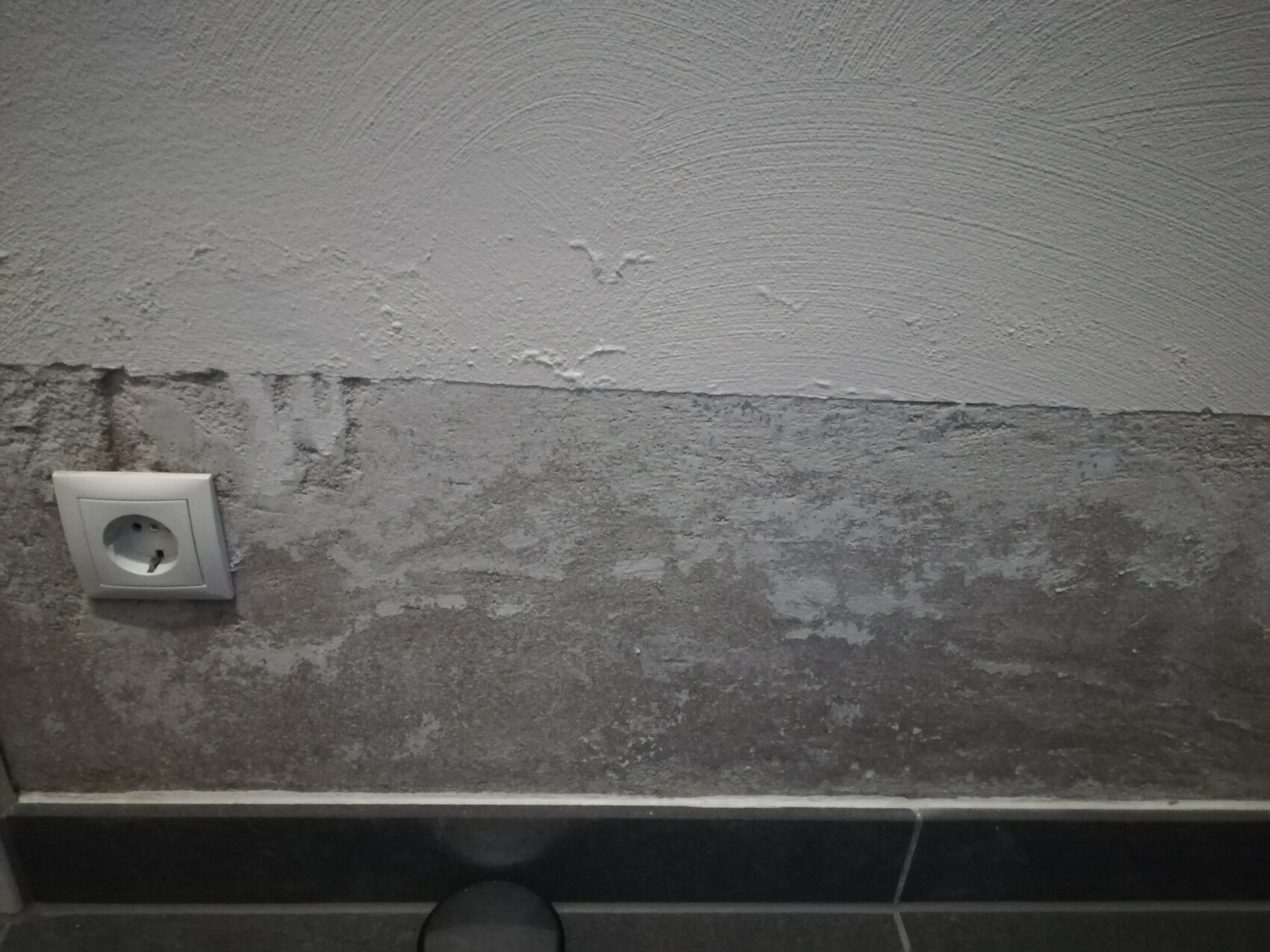

We have a moisture problem behind our front door. Since the guest bathroom is directly behind this wall, we initially suspected water damage. However, it seems to depend more on the weather. We consulted our architect, who after much back and forth provided several explanations and possible remedies:

For us, these explanations do not align at all. Therefore, here are our open questions:
1. What could it be?
2. Who is the best professional to inspect this?
3. Is the architect responsible if he supervised the construction but we did a lot of the work ourselves?
The photos are from October 2017 (yes, we have been pestering the architect for a long time but keep getting postponed). Currently, the damage looks the same, but it has spread up to about 1 meter (3 feet) high. We have already started removing the paint. Afterward, the paint simply peeled off further up.
We would appreciate any input from you. Of course, I can provide more information if needed.
Stefan

MIkro198622 Jan 2019 17:19Before asking about construction measures and liability, one should first identify the cause. This is probably not straightforward, and I would recommend consulting a building inspector or expert.
To me, it looks like the plaster is absorbing moisture from below. Possibly the sealing around the front door at the base is not okay?
We once had a similar mystery. In the living room of my parents’ house, a few spots of plaster were flaking off near the bottom of the wall. At first, we assumed it was due to the exterior wall. However, the real cause was a water pipe running across the living room on the unfinished subfloor that had developed a leak. The distance to the wall was about 2.5 meters (8 feet). On top of that was a floating floor. The water ran underneath the insulation toward the wall and gradually climbed up the plaster. It took several months before we identified the cause.
ChristianSt8114 Nov 2020 02:25Hello,
we just came across your post and have exactly the same problem. The moisture pattern and the rooms are identical. We hope you have identified the cause of the damage and would appreciate it if you could share your experiences with us. For us, basically two possibilities come into question: a faulty seal on the front door or damage in the adjacent bathroom, although no water pipes are expected in the shared wall. It could still be that the concealed cistern or the pipes in the bathroom are causing the problem, but the moisture only appears on the hallway side (tiles in the bathroom). We would appreciate any feedback.
