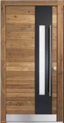

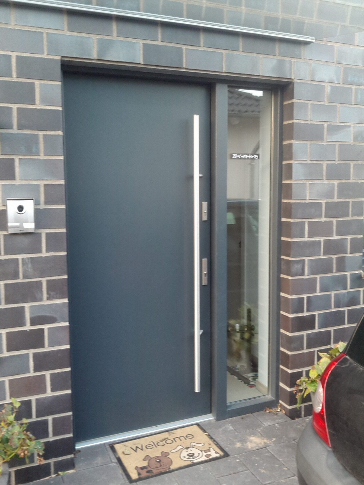

nordanney26 Oct 2015 17:09SirSydom schrieb:
For us – including the side panel, total width 2.01 m (6.6 ft) – the general contractor estimated €4,000 for contractor 1 and €5,000 for contractor 2.
If we choose aluminum, we can stick to the €5,000 budget by skipping the automatic lock (Bayerwald).
Our preferred wooden door costs €8,200. We are still considering whether it is worth it.
And yes, the prices shocked me as well.
By the way, Toom currently has an exterior door on sale for €279.We found the wooden door to be the most affordable option, even significantly cheaper than doors made with window profiles. Feel free to explore options in that category. For very little money, it can look like the attached example. Oak door in anthracite, side panel with triple glazing.
