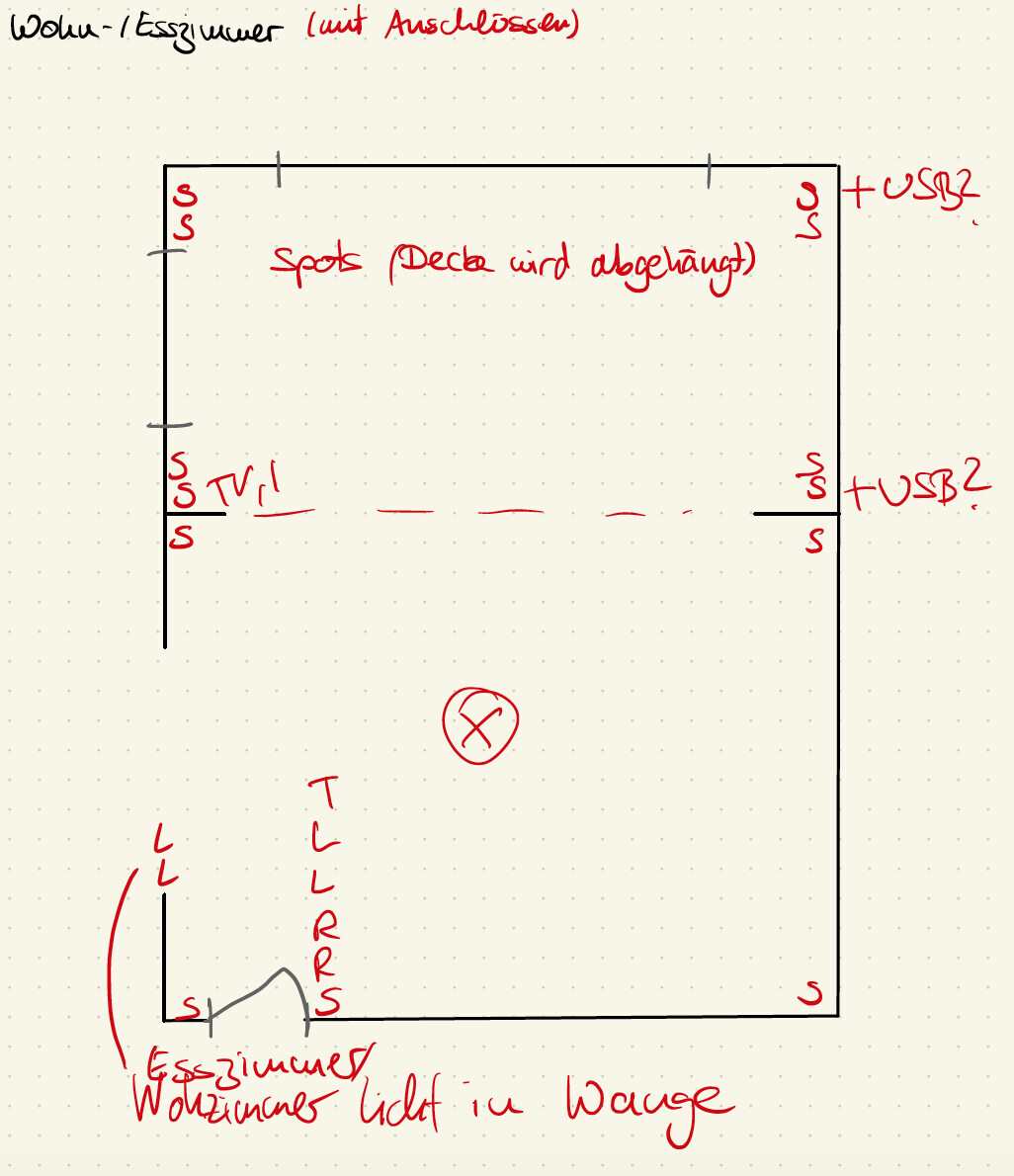

1. a) In the living/dining room, you see the two windows and the planned connections. Any ideas? See attached photo.
1. b) Do you have a solution for the many switches by the door to the dining room?

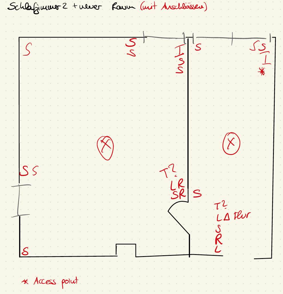

2. On the upper floor, you see the newly partitioned room including the access point for WLAN upstairs, possibly downstairs and mainly for the terrace/garden. Does this look good? See attached photo.

6. The location of the TV is suboptimal because of the two windows in the living/dining room. We don’t want to place the sofa with its back to the garden (which would be optimal for the TV) but somewhat angled from the left window, where the TV connection is also marked. Your feedback?

i_b_n_a_n30 Jun 2022 00:12
1. b) Do you have a solution for the many switches on the door to the dining room?
-> Many switches could ideally be reduced to just one by using any form of smart home technology.
3. In all bedrooms and the living room, double LAN outlets (CAT-7?) will be installed. Does that sound right?
-> I think that’s a good idea.

Westfale0101 schrieb:
6. The location of the TV is suboptimal due to the two windows in the living/dining area. We don’t want to position the sofa with its back to the garden (which would be optimal for the TV) but rather slightly angled from the left window where the TV connection is marked. Any feedback?
This is still open here as well—what would be the best way to implement this? Feel free to ask questions.

Dear electrical experts,
if you have any further suggestions, ideas, or comments regarding the questions or the original post, we would be happy to consider them and reflect on them.
In particular, question 6 (TV and windows) has not yet been definitively resolved; please also see the attached sketch in the original post.

1b
I've never seen a roller shutter switch by the entrance door; I would place it near the dining table or the sofa. You turn lights on or off when entering or leaving a room. Roller shutters are usually operated when you’re sitting somewhere and the sun is bothering you.
2
Why should the access point be placed in the very corner? An access point is usually positioned as centrally as possible, ideally mounted on the ceiling.

6
The TV position is… difficult. I would never put a TV directly next to a window. Even on the north side, it creates a distracting reflection; on west, south, or east sides, the sun inevitably causes glare. Always pulling down the blind? Maybe place the TV on the opposite wall?

xMisterDx schrieb:
1b
I’ve never seen a roller shutter switch by the front door; I would place it near the dining table or couch. You usually turn lights on or off when entering or leaving a room, but you operate shutters when you are sitting somewhere and the sun is bothering you, right?
That’s true. However, the classic way is shorter in the evening. But we will take that into account and reconsider.

2
Why place the access point in the corner? An access point should ideally be installed as centrally as possible, preferably on the ceiling.
Indeed. It will also be mounted on the ceiling. However, since it should cover the adjacent rooms (the bathroom is opposite) as well as the garden with Wi-Fi as much as possible, it will be positioned in the middle of the room facing centrally toward the garden.
xMisterDx schrieb:
6
The position of the TV is... difficult. I would never place a TV directly next to a window. Even on the north side, it becomes very distracting, and on west, south, or east sides, the sun inevitably causes glare. Always pulling down the roller blind? Maybe put the TV on the other wall?
The latter has been and still is an option. But then the view away from the garden is lost, which is just as unfortunate. It’s difficult…
