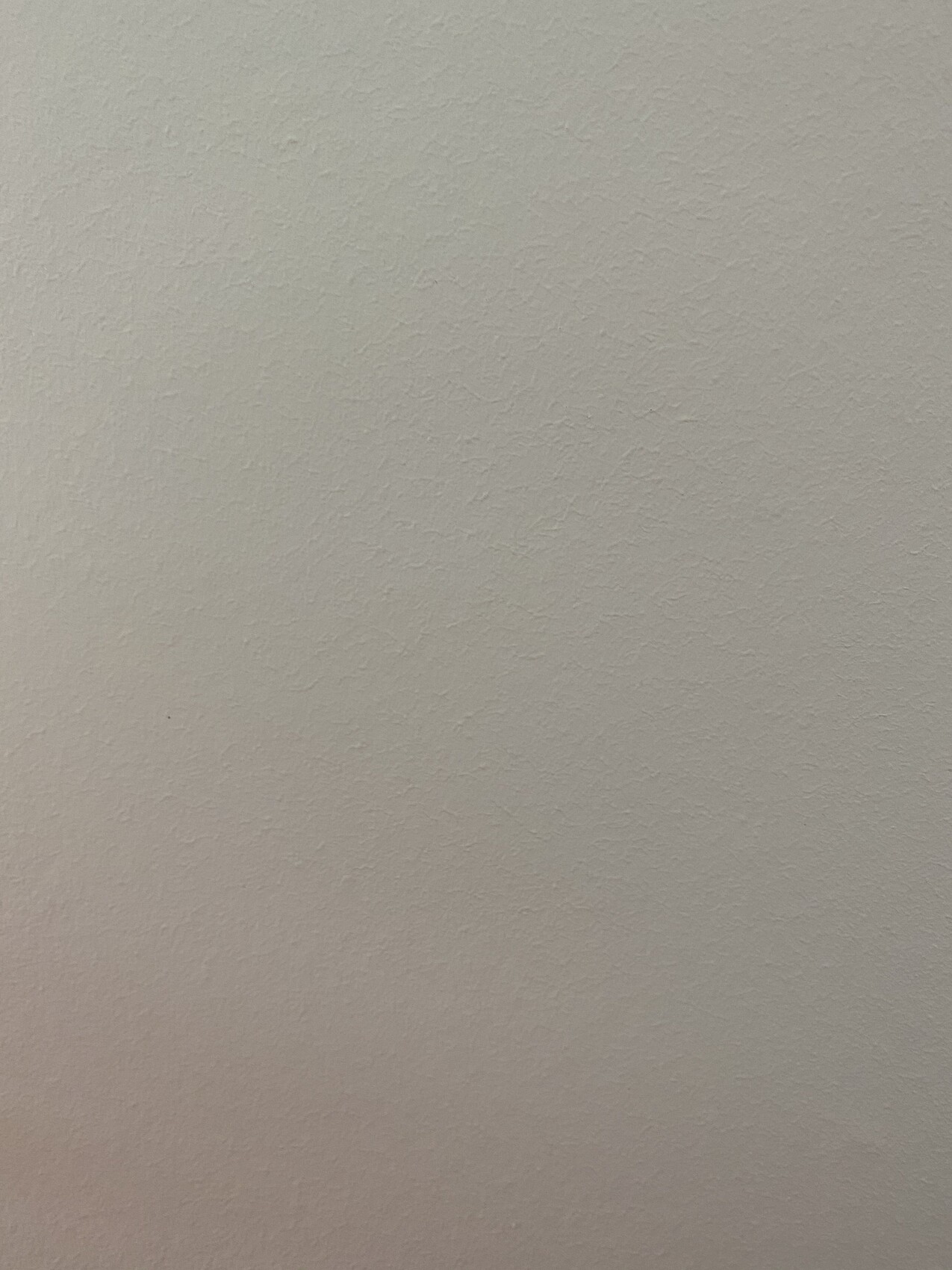

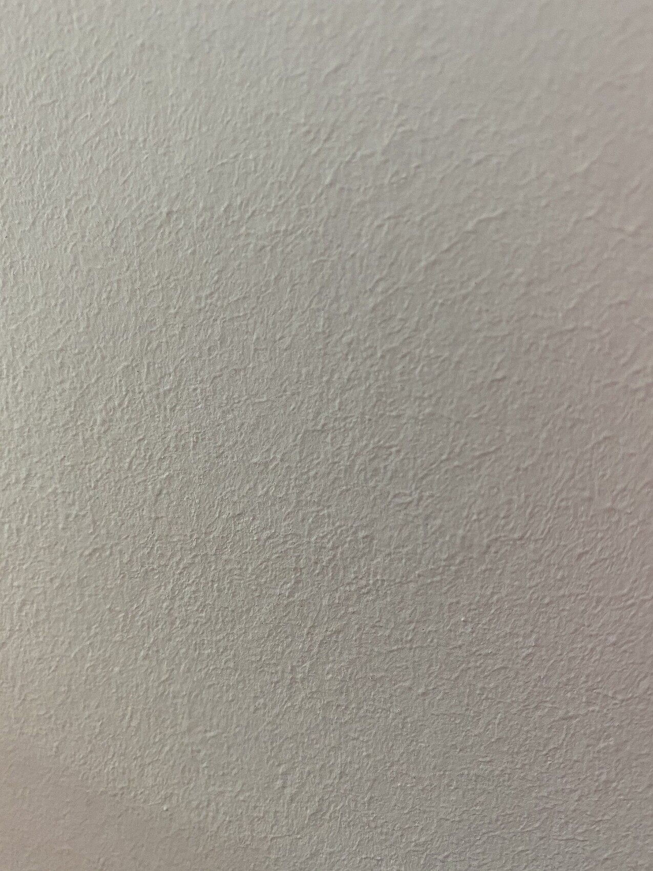

goalkeeper19 Jun 2020 20:19We absolutely love our upgraded Q2 walls. Of course, you can still see here and there in the grazing light that it’s not Q3 or Q4 level. However, we were aware of this from the start.
You always have to consider the alternatives: either a complete house with textured wallpaper showing imperfections, or one with occasional minor cosmetic flaws. And when I think about the extra cost for full-surface skim coating, we’d gladly accept a few spots that aren’t 100% perfect.
Attached are photos taken very close up and from a bit of a distance. This is painted renovation fleece weighing 150g (5.3 oz) from Relius.
