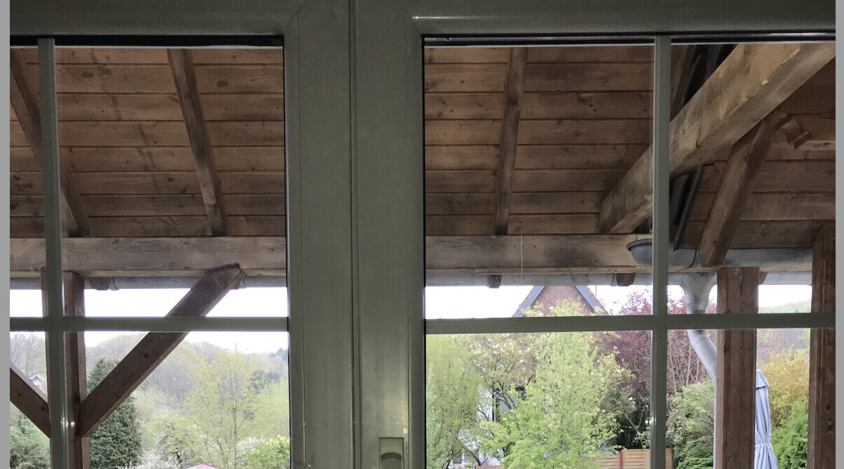

Currently, the eaves and the roofing over our terrace (both made of wood) are being renewed for the first time on our house (built around 2000). The wood was completely sanded and then coated twice with a thin-layer wood stain.
Since the terrace roofing covers a larger area, the stain was sprayed on there instead of being applied with a brush or roller. The result: everywhere the brush or roller was used, the finish looks very good, but in the areas where it was sprayed (only on the terrace), the appearance is not good. The surface looks very blotchy, with some spots lighter and others darker than the rest. Additionally, there are several thinner streaks visible (like liquid has gathered and run down with the slope).

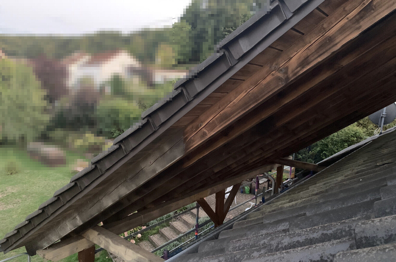

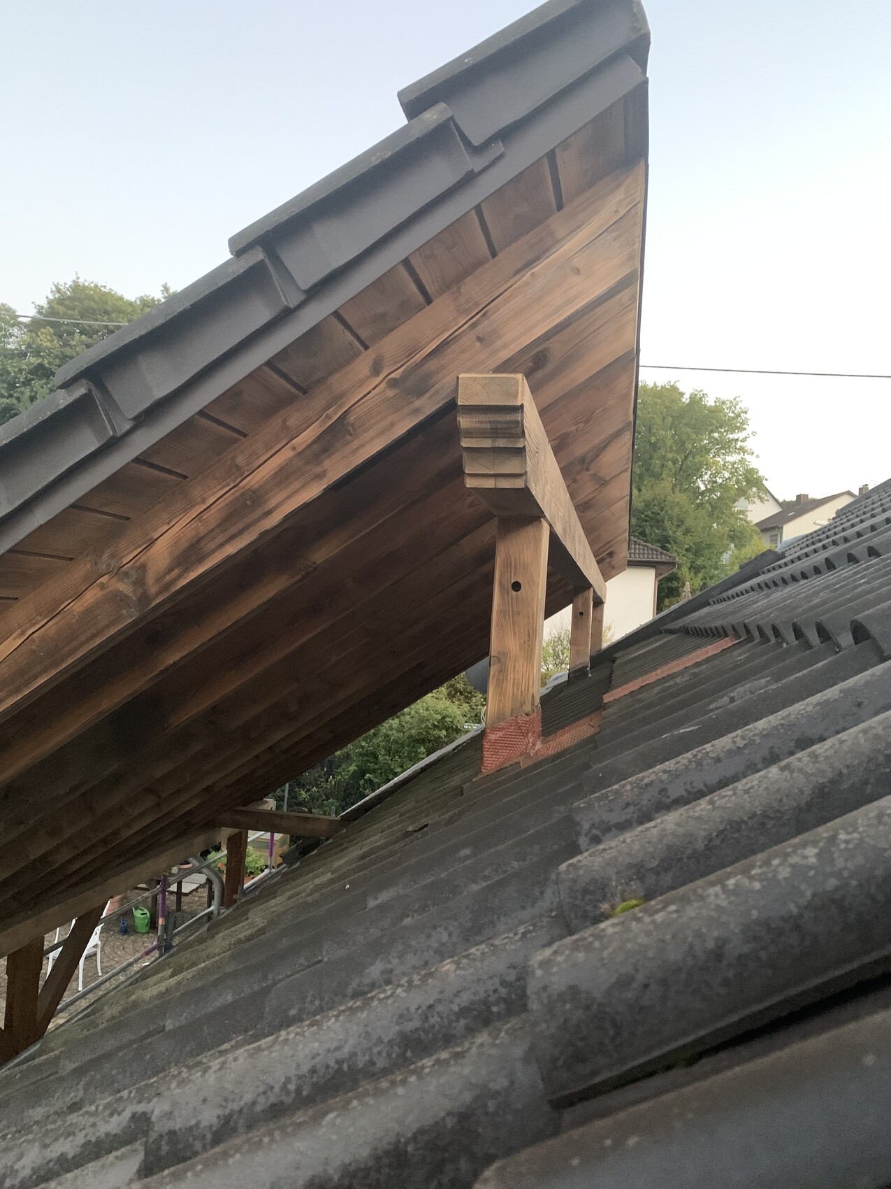

Photos before the new coats of paint:
Terrace before:
Terrace before (left) vs. sanded (right):
Terrace sanded:

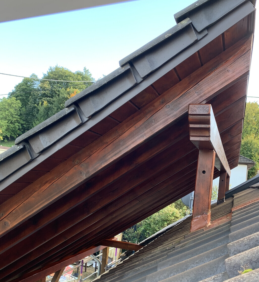

Terrace after 2 coats of paint:
To our eyes, it looks good everywhere except in the "interior" area of the terrace (first image above). Exactly where the surfaces were spray-painted instead of brushed or rolled.
Do you think sanding would improve this overall or possibly make it worse?
