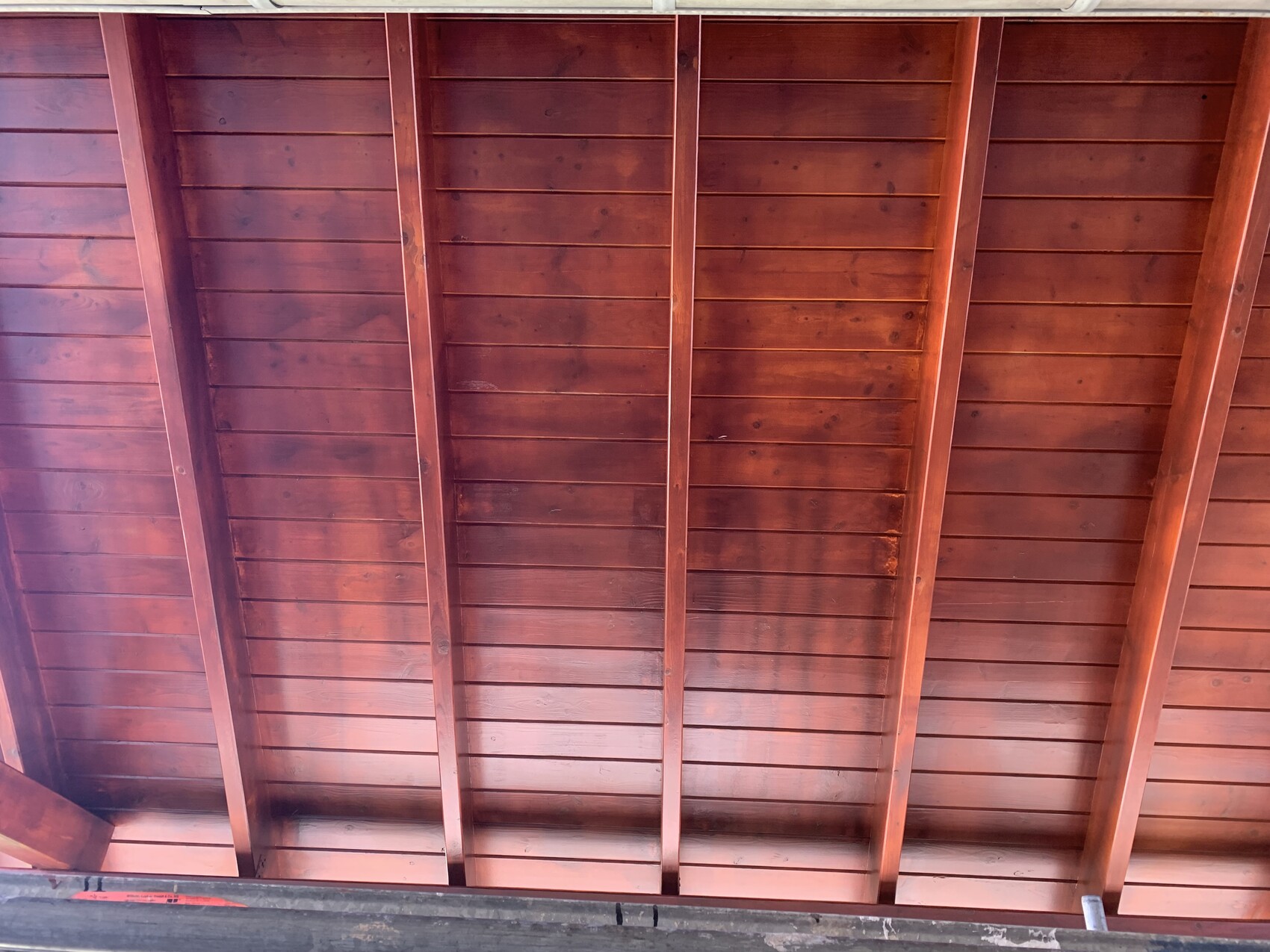

Here is a picture of the "terrace" area:
Underside of a reddish-brown wooden beam ceiling with horizontal boards and visible beams.
The question is, what would a repair look like here?
- Re-staining would probably make it look darker compared to the rest (and it’s questionable whether that would eliminate the unevenness)
- Sanding seems to be the only option, right?
driver55
3 Oct 2022 12:12
[ATTACH alt="IMG_7258.jpeg"]75327[/ATTACH]
The question is, what would a repair here look like?
- Applying another coat would make it noticeably darker compared to the rest (also uncertain if it would even out the unevenness)
- Sanding would probably be the only option, right?
In some spots, too much stain has been applied. Has everything dried completely?
And as a comparison, what does the roof overhang look like?
Peter35
3 Oct 2022 12:34
2. The second coat in the terrace area was applied about 1 week ago, so I would say yes.

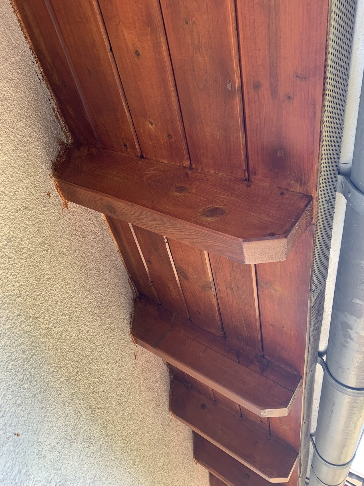

Roof overhang:
Wood-clad roof overhang made of brown boards; wall and gutter visible on the side.

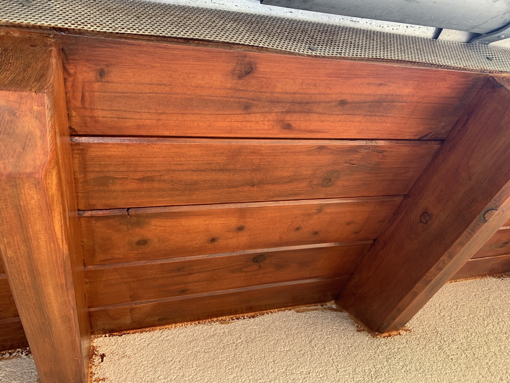

Underside of a brown-painted wooden deck with side posts and metal mesh.
