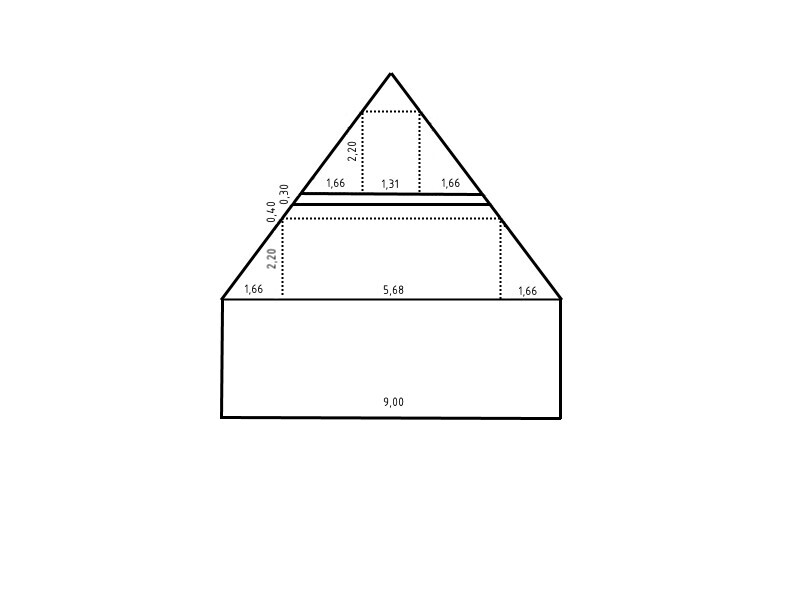

Technical drawing: rectangular floor below, steep roof above, interior dimensions indicated.
If no knee walls are planned in the attic, then more than half of the floor area is below 2.20 meters (7 ft 3 in), meaning that according to §43, paragraph 2 of the Lower Saxony Building Code, no habitable rooms are allowed there, and the attic is considered a cavity space under §2, paragraph 7, sentence 4, which does not count as the top floor. At the same time, 5.68 meters (18 ft 8 in) of the gable length are above 2.20 meters (7 ft 3 in) clear height, which corresponds to 5.68m/9.00m = 0.63 = 63% < 66% (2/3), so it is not considered a full floor.
