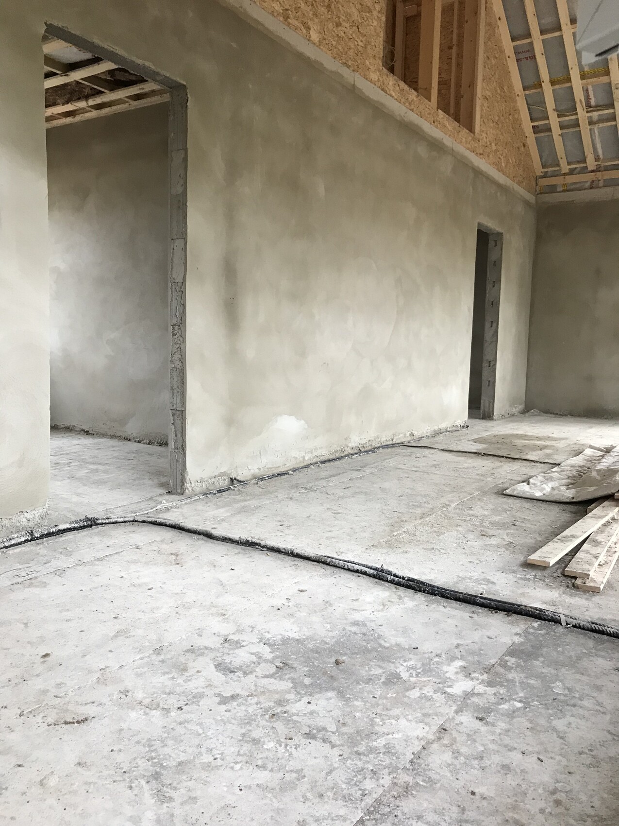

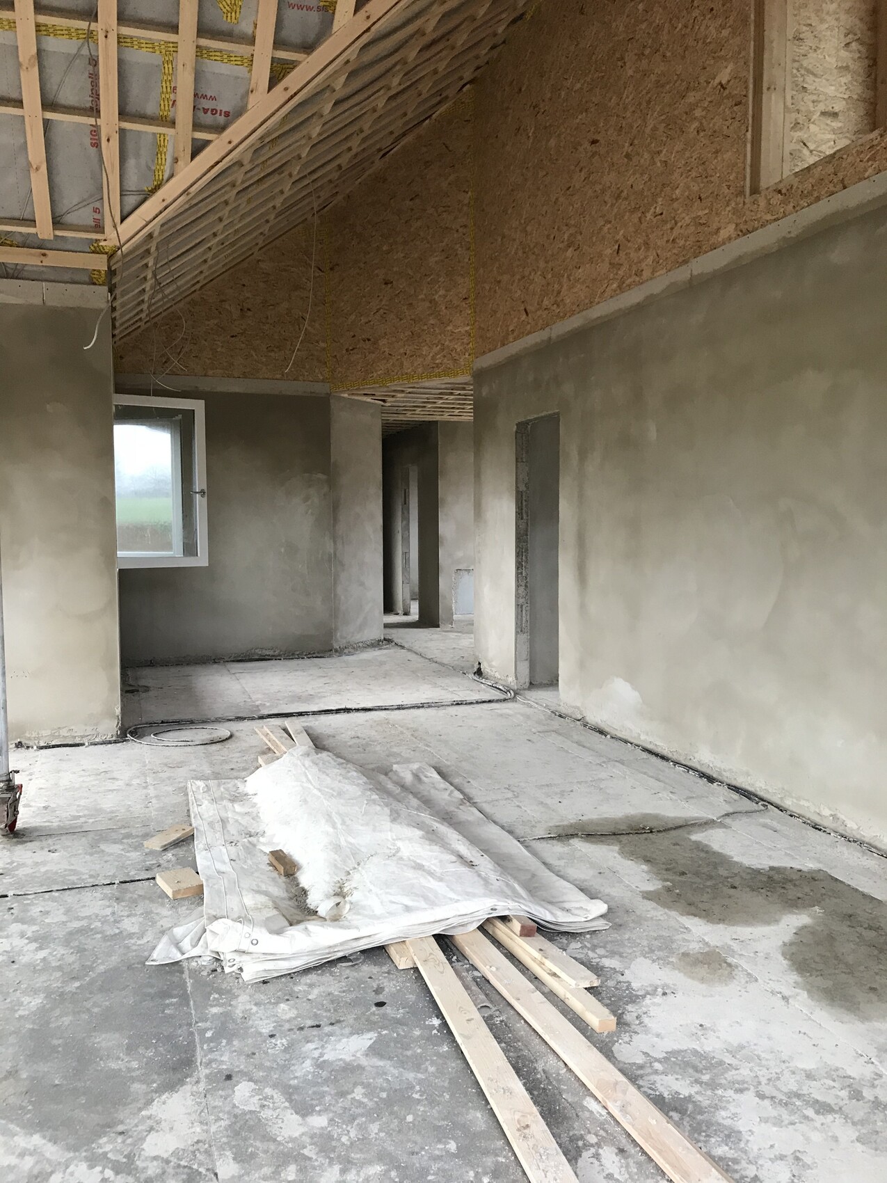

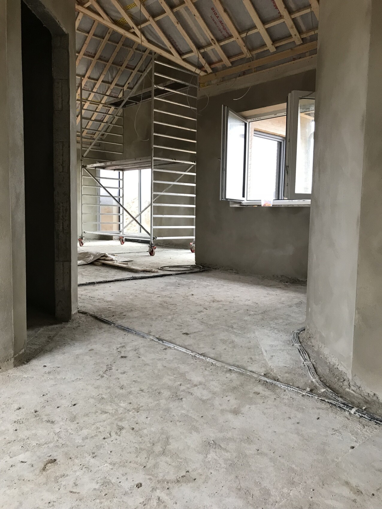

blaupuma18 Jan 2019 08:37
Escroda schrieb:
Oh, it looks like you were sold a commercial hall instead of a bungalow.
Show us some pictures!
I think the original poster isn’t concerned with the legal definition of a full storey, which no longer exists in Bavaria anyway, but rather about where the roof begins: below or above the second floor ceiling. The latter being cheaper, I consider possible. Ultimately, though, the structural builder is the best person to decide. He can compare the alternatives, then it becomes clear where the costs lie.
Interior of an unfinished construction site with scaffolding, cables on the floor, and an open window.
Raw interior of a construction project with unfinished concrete walls, door openings, and a wooden ceiling.
Unfinished interior of a construction site: raw walls, wooden beam ceiling, building materials on the floor.
E
Escroda
18 Jan 2019 14:09
Cool. However, I wouldn’t call it a bungalow anymore.
