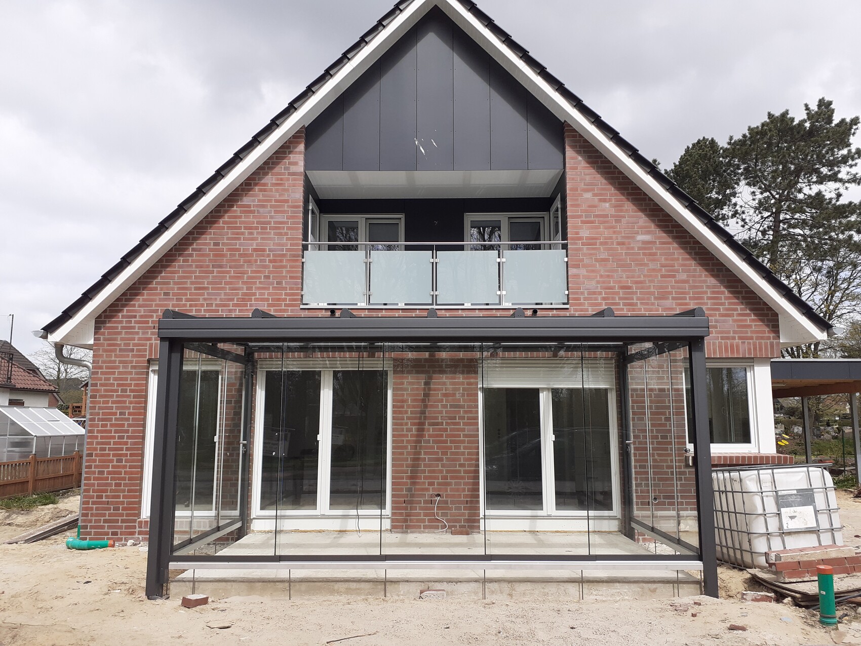

Heidi19652 May 2021 14:22The attic of our new build is accessed by a pull-down ladder. There are no windows there – neither in the gable nor any roof windows.
During the building drying phase (after plastering and after the screed), the hatch to the attic was completely closed. This was explained to us as a way to prevent mold growth. Since then, the pull-down ladder has been installed, and the attic has been lined with drywall panels. Now we notice a musty smell there, and mold spots are forming on the panels.
What can be done at this point? I have also asked the carpenter for advice at the same time.

Was the roof planned this way from the start? An architect designed the house. However, he originally planned skylights in the attic area. We didn’t want those because photovoltaic modules were to be installed on that part of the roof. There was never any talk of windows in the gable. On one side there are bricks; on the other side, facade panels, so it wouldn’t be possible to cut holes later anyway.
