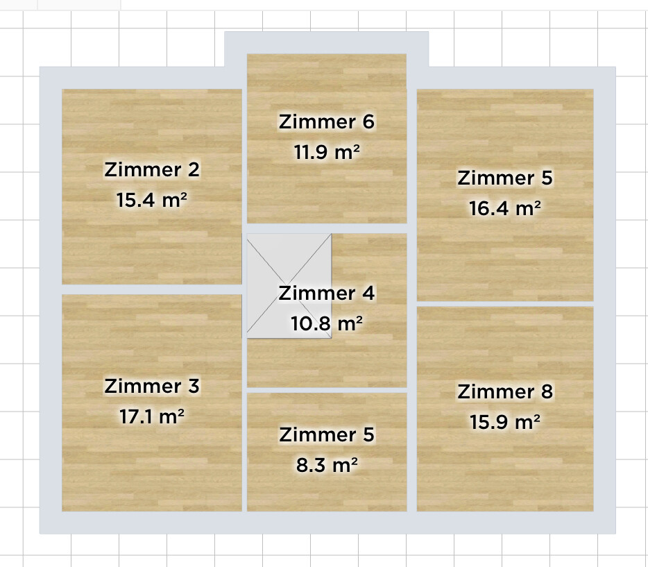

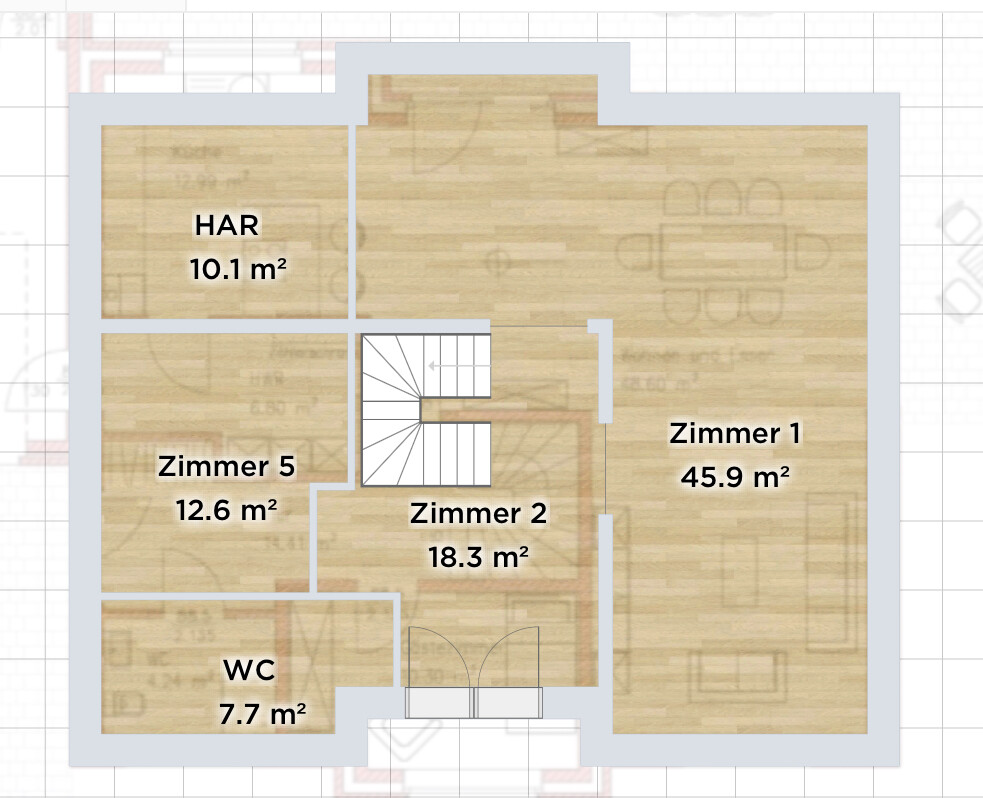

nordanney22 Jul 2024 11:00klabauter8614 schrieb:
Personal price limit for the house, including fittings: 650kReconsider the budget. That is a very large house with a garage for a very low price.Others are responsible for the floor plans.
The utility room is half unusable due to the insertion of the wardrobe (which actually makes sense) and is therefore too small.No, the utility room is unusable because of the two doors. What is supposed to go in there?
And why a door when the front door is right next to it?
The more I look at it, the more complicated I find the access to the open-plan living area. However, the sofa then feels a bit too far away for my taste.
The utility/storage room is far too small for your multifunctional needs. And the open-plan living area is too elongated.
Here is my suggestion, but please consider it only as a rough sketch. The staircase would need to be enlarged and reversed, and the partition walls adjusted.
The more I look at it, the more complicated I find the access to the open-plan living area. The sofa then also feels too far away for my liking.
The storage room is far too small for your multifunctional use. And the open-plan area feels too elongated.
Here’s my suggestion, but please consider it only as a rough sketch. The staircase would need to be enlarged and mirrored, and the temporary walls adjusted. I completely agree with you. What bothers me most about the original design is this uninviting entrance hall. You come in and step into a dark space with a staircase. The exit lies tucked away, narrow and inconspicuous around the corner.
Your sketch is already better in comparison. I would rotate and mirror it further until the entrance is again on the left side of the plan. Possibly also replace the staircase to allow easier access to all rooms on the ground floor.
K a t j a schrieb:
I would rotate and flip it until the entrance is back on the left side.This is how I started. However, there is only a small window above for the staircase. This also helps to avoid confusing corridors upstairs.
The staircase on the ground floor was always in the way.
