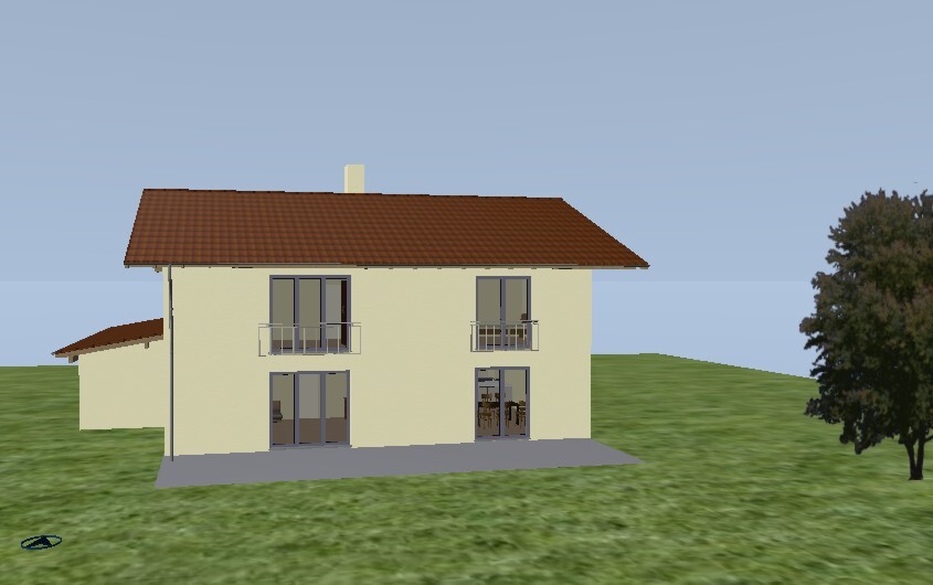

I’m not a fan of strict symmetry, but I would make the two windows and terrace doors (?) on the south side on the ground floor and first floor the same size. But it’s okay as it is, too.

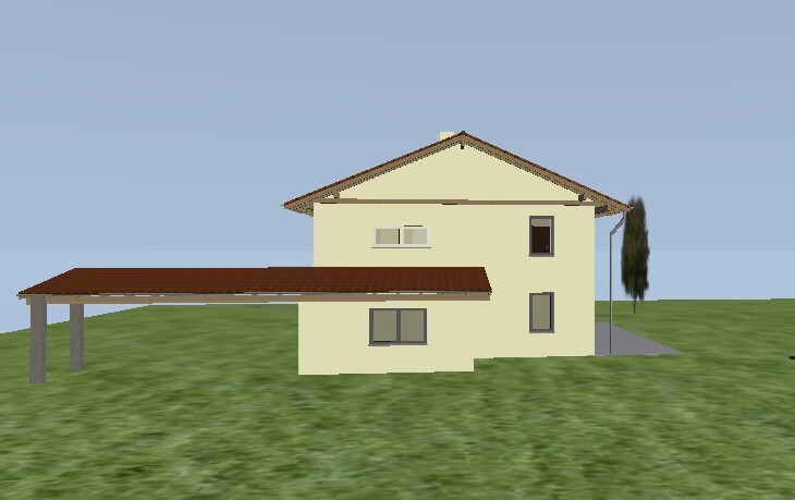

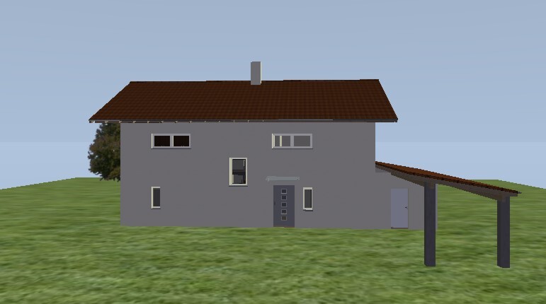

The windows are roughly aligned. I’m attaching the elevations. Maybe this will also clarify the situation with the carport. The west elevation will follow in a later post, as I might not be able to upload it due to file size limits.
You are right about the window for the downstairs bathroom. We still have to figure something out there. The challenge is to keep the north elevation looking harmonious.
The roof is not quite right yet; the crossbeam and the supports don’t fit. So please ignore that. The same applies to the roof of the utility room and the carport.
