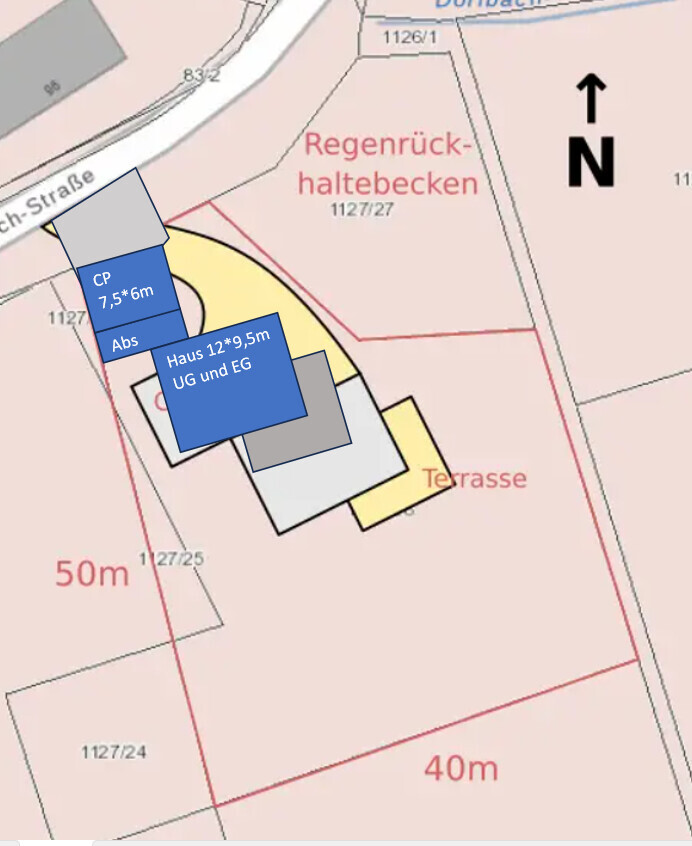

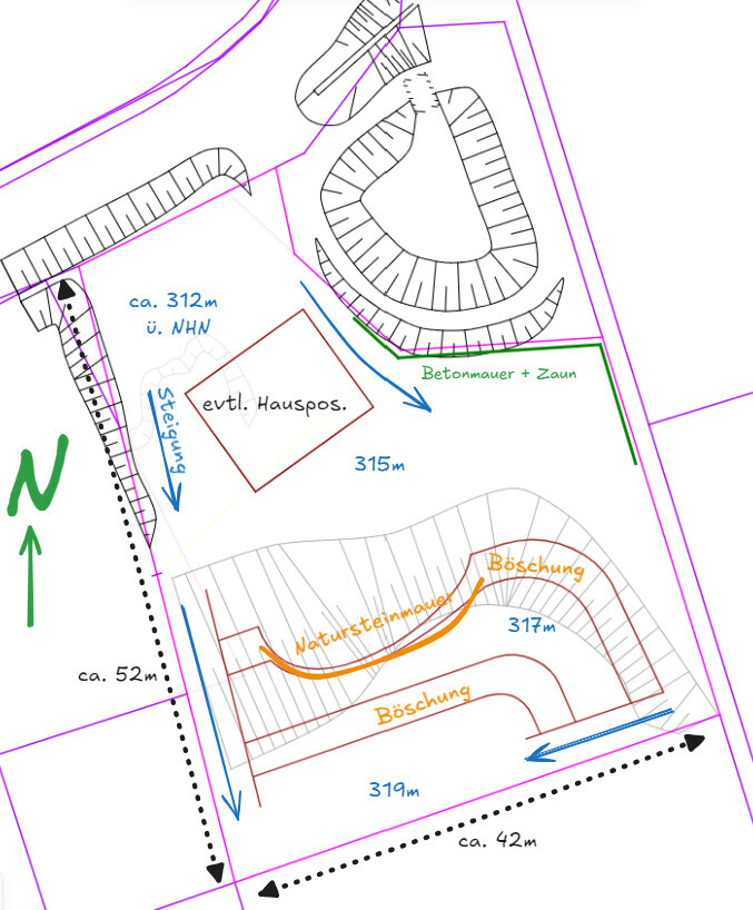

Hello fellow home builders,

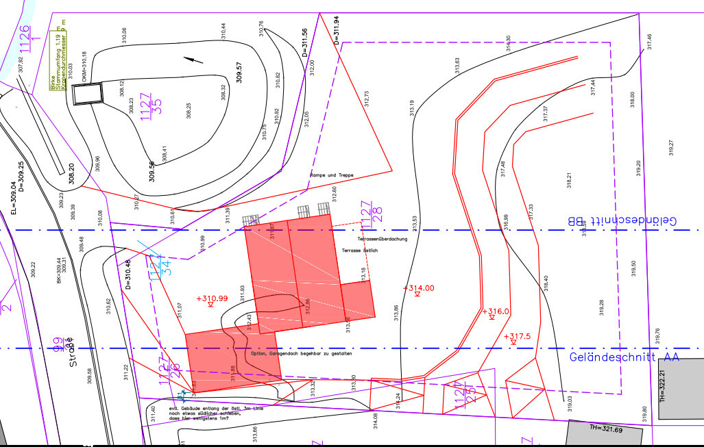

We have been reading this forum for several weeks now. We are still in the research phase and have decided to build a solid masonry house. We have already reserved a plot of land. This plot has a significant slope, which we plan to level by landscaping the terrain. Any excess excavated soil will likely be easy to get rid of. So far, we have not involved an architect because the costs and the uncertainty of the outcome have deterred us. Therefore, we are doing a lot of research ourselves and are making intensive use of the information in this forum.
We believe we have found a suitable solution for our single-family house. The structural engineer/architect from our general contractor (GC) implemented our ideas and wishes but offered hardly any of their own suggestions or improvements. As laypeople, it is difficult for us to judge whether we have truly achieved the best possible result.
We would now like to draw on your experience and expertise and look forward to your honest opinions and possible improvement suggestions.

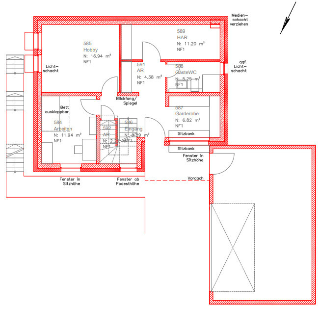

- House entrance in the basement
- Southeast terrace

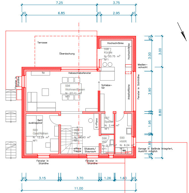

- Kitchen not visible from the living room

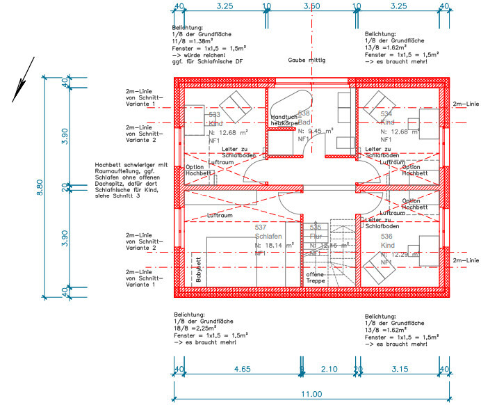

- Three children’s rooms + two offices/guest rooms
- We like the open and integrated staircase and the entrance in the basement because it keeps the ground floor hallway free for living space
- Very flexible room usage possible due to similar room sizes

Maybe reconsider everything from the beginning. How many children? Desired age gap between the children. I know from friends that their children only wanted separate rooms in their teenage years. Recently, three children's rooms are being used for four kids. The oldest just turned 18 and plans to move out with their partner. The youngest is 5. Most likely, four rooms will never be fully used.
How much longer will grandma stay and be able to help, especially since the shower is not on the same floor as the sewing/guest/whatever room?
A living room that can possibly be divided or even separated, and instead a kitchen-living area that doesn’t feel crowded when the youngest stacks building blocks, the elementary school child does homework, and the preschooler has friends over who will later eat together.

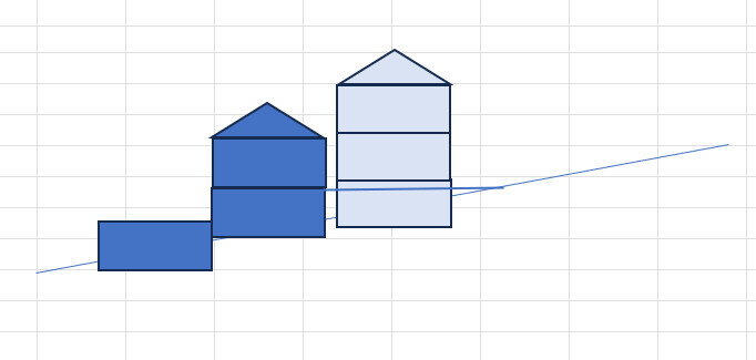

In my opinion, the house could be raised a bit. This would save you two levels. The ceiling height could also be a bit lower.

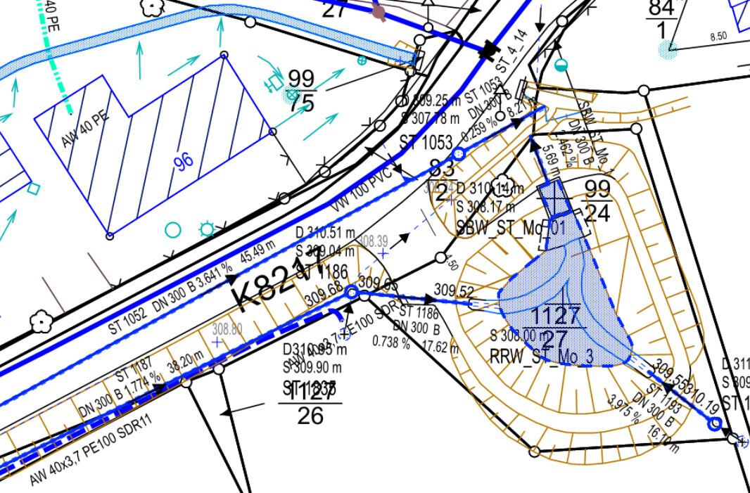

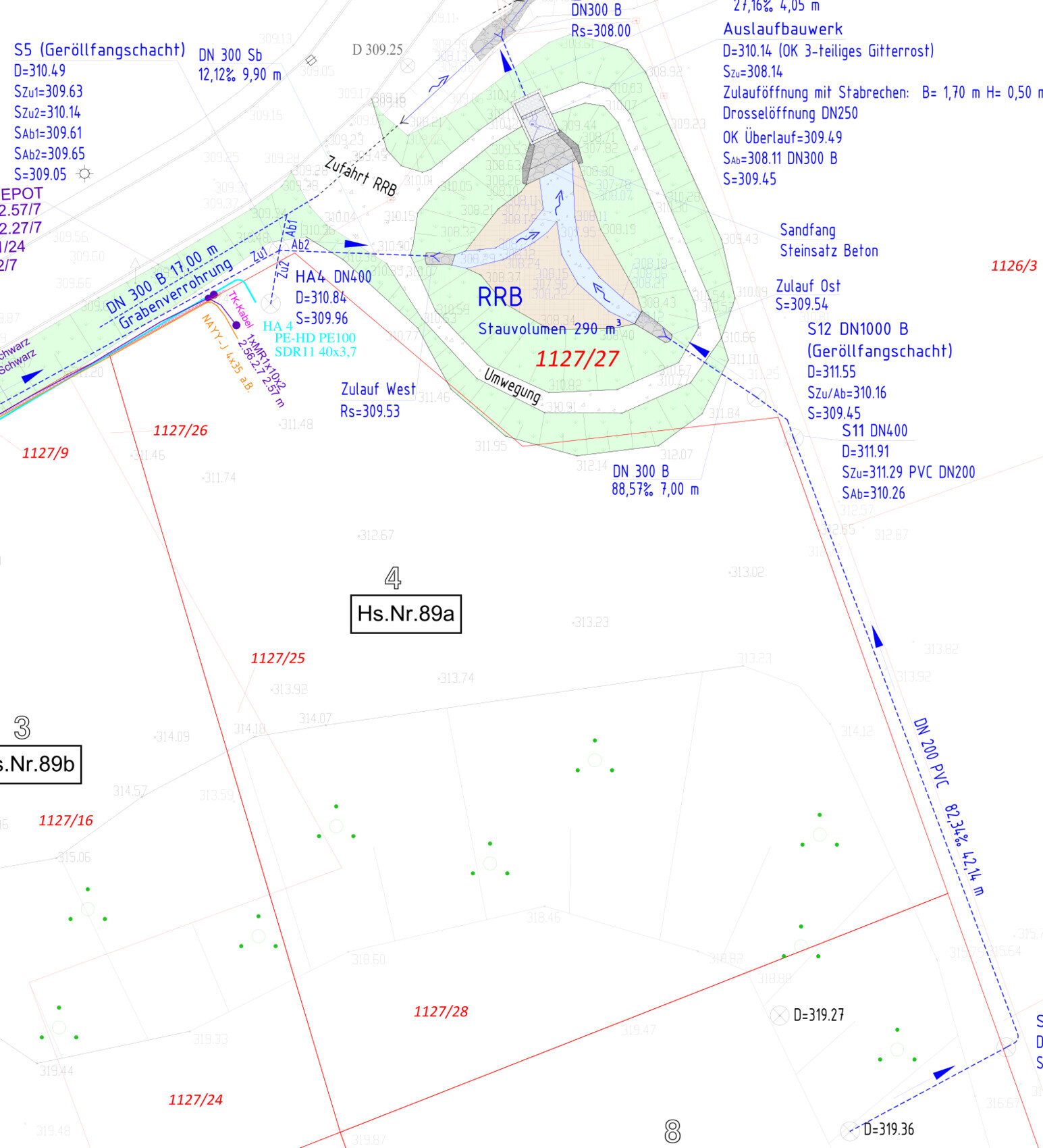

You can then place the excavation under the carport and driveway. Where exactly is the water pipe located? Is it recorded in the land register? I have two plans showing the location of the water pipe. I hope this helps, and thank you for the reminder.
The pipe runs along the street parcel.
Don’t be surprised, we also purchased the plot with an approximately 30sqm (323 sq ft) triangular piece by the driveway to create a private entrance without an easement. This is not shown in the older plans here.
