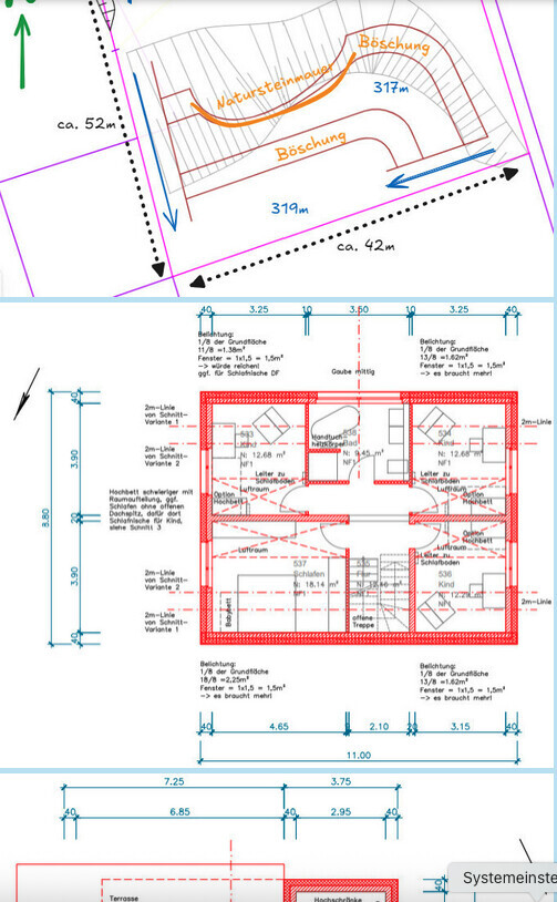

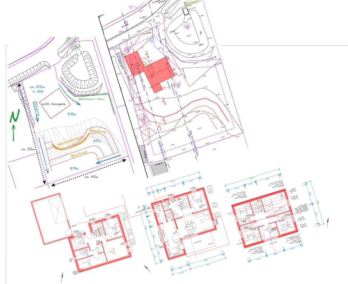

The different north arrows confuse me!
Site plan with terrain features and floor plan of a house
kbt09
11 Sep 2025 14:06
I believe only the green arrow indicates true north. The black arrows are more like directional arrows, possibly showing earth movements or similar.
The main issue, as always, is that the plans are set in different orientations. Here, there are three different orientations.
Compiled here just for an overview:
Architectural plans with property and house floor plans and terrain profile
What stands out very negatively is the south corner of the ground floor with the kitchen, where the tall cabinet corner is planned. I consider this worth redesigning. The 3m (10 feet) wide kitchen doesn’t really work well—it’s neither a good galley kitchen nor a proper island kitchen or similar, and the current layout wastes usable floor area.

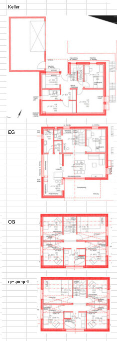

11 Sep 2025 18:41
Thanks @kbt09, I was just about to ask the original poster to show it properly rotated. This way, you can even notice that the upper floor, in my opinion, should be mirrored.

kbt09
12 Sep 2025 08:16
hanghaus2023 schrieb:
This way, you even notice that the upper floor should be mirrored in my opinion.
That's correct, the original attachment is wrong; the staircase layout does not match.
