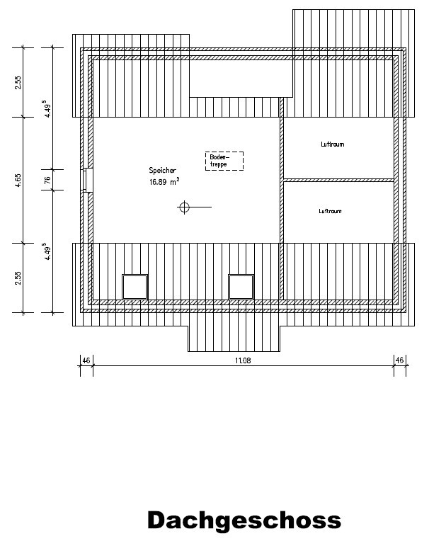

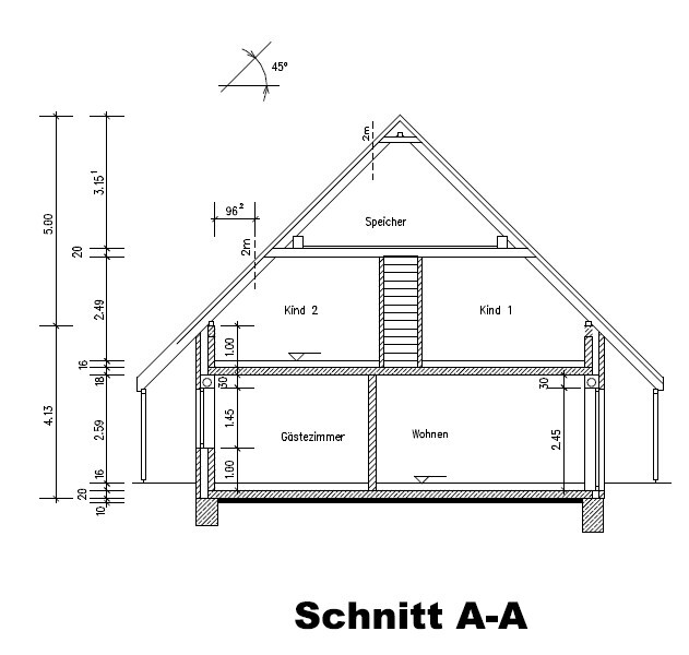

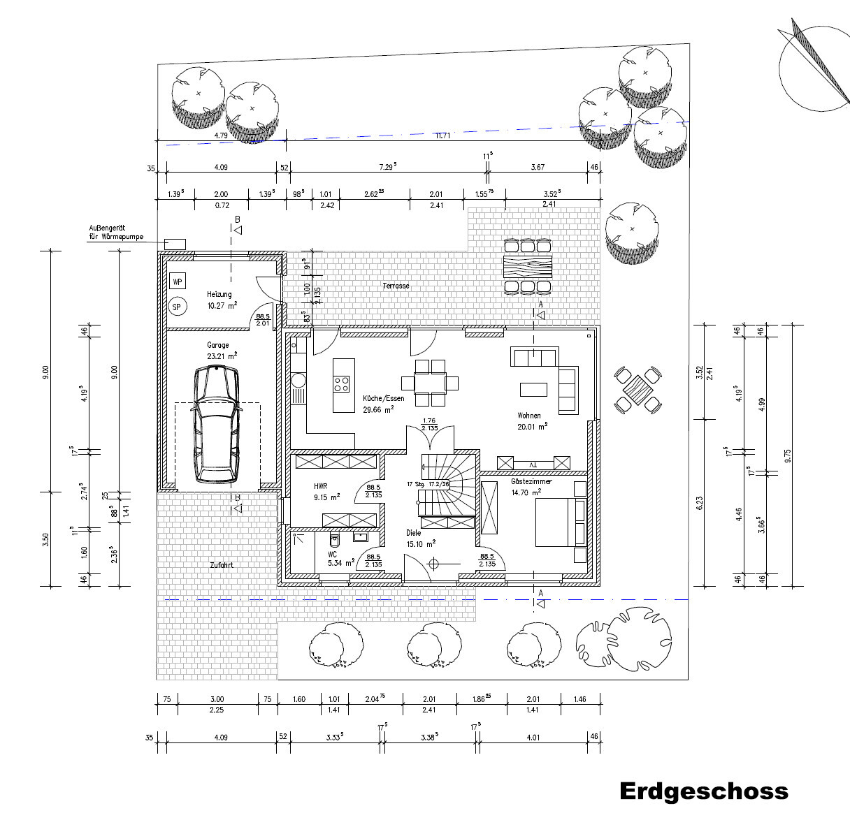

We spent several hours together going through everything, which was much better than this back-and-forth. This is the result. I hope all views and dimensions are visible this time. The technical room is still drawn in the garage; I will need to clarify why during the next appointment. Otherwise, I am just weighing the smaller living area versus the larger length in the living room. Nothing else immediately stands out; it looks much better than the previous versions.
Ground floor plan: garage, kitchen/dining, living room, guest room, hallway, terrace, garden.

Attic floor plan with storage room (16.89 m² (182 sq ft)) and open spaces, dimensions.
Section A-A through a house with guest room, living room, children’s rooms 1–2 and storage.
