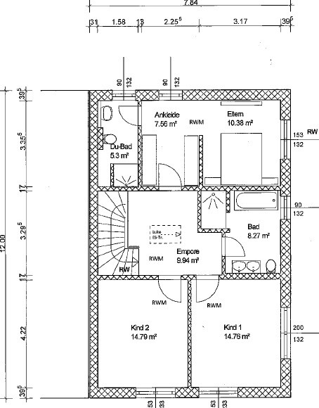

My wife and I have tried to create a desired floor plan based on our requirements.
However, we noticed that the hallway on the upper floor is really large (therefore wasted space). We would like to get your suggestions for improvements.
Thank you in advance for your ideas!

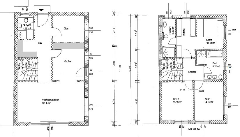

26 Apr 2021 00:34
musik_de schrieb:
The updated plan should make the entrance area larger.
It’s still long …
musik_de schrieb:
by enlarging the entrance area and slightly narrowing the hallway.
… but there’s still no space for a cloakroom in sight.
RomeoZwo26 Apr 2021 10:00
Walk-in closet and shower bath – does this work at the corner of the wall like this? I would swap the door positions there (and possibly also rotate the bed position accordingly).

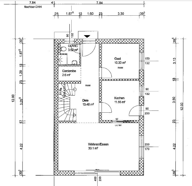

27 Apr 2021 16:10
I like RomeoZwo’s idea. I’d like to suggest another option if you change the staircase. This would break up the long hallway downstairs, create space for a coat area, and not take as much space from the upstairs landing. I think the passage by the staircase can be narrower—it feels different there because there aren’t two walls, but rather the space opens up.

Dressing room and shower bathroom – does this work at the corner of the wall like this? I would swap the door positions there (and possibly rotate the bed position as well).
Thank you very much for this idea. We also wanted our bed to face north, and your suggested solution is really nice. We hope to receive an updated plan tomorrow.
Würfel* schrieb:
I like RomeoZwo’s idea. I want to add another suggestion if the staircase is modified. It breaks up the long hallway on the ground floor, creates space for a coat closet, and doesn’t sacrifice as much space to the landing upstairs. I think the passage by the staircase can be narrower; it also feels different because there aren’t two walls there, but the room opens up.
Your idea regarding the stairwell makes sense. When designing the floor plans with Architekt 3D, I used a similar-sized staircase. Unfortunately, this is a prefab house, and we are quite limited regarding the size and design of the staircase. Considering that, the staircase we currently have is the best compromise.
musik_de
29 Apr 2021 11:24

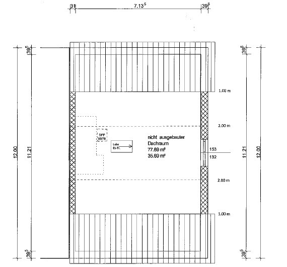

The architect has sent us the updated version (attached below). The hallway on the ground floor was not changed much, as the architect believes that reducing its width compared to the entrance door would not look good.
I would like your opinions on a somewhat complicated topic. Considering that some of you mentioned the hallway might be too dark, I had the idea to install a skylight right next to the stairs (due to a 1.25m (4.1 ft) distance from the party wall). My idea is to ask the prefab house company to leave a hole in the attic floor so that the light from this skylight can shine down onto the stairs, possibly making the hallway less dark. Now, the questions:
1. Does this make sense?
2. How can I optimize the size and position of the hole in the attic floor for this skylight and stairwell so that in the future, if I want to develop the attic, I can use this hole to create a staircase?
I appreciate your answers to the above questions and any feedback on the floor plan in general.
Thank you very much!
