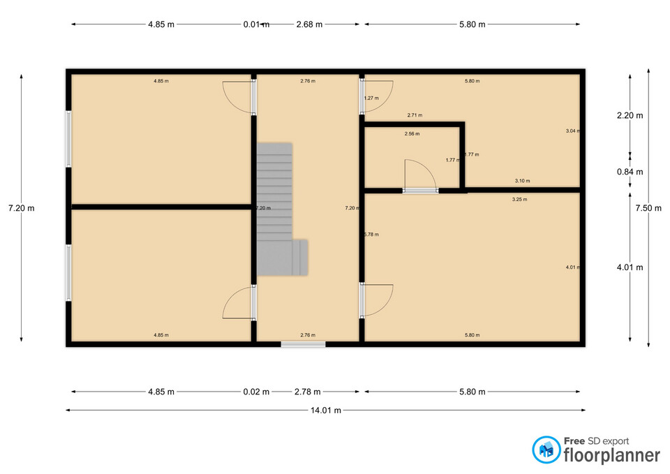

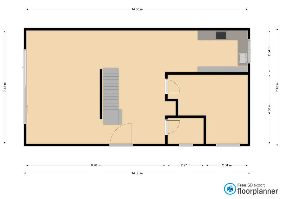

My wife and I have tried to create a desired floor plan based on our requirements.
However, we noticed that the hallway on the upper floor is really large (therefore wasted space). We would like to get your suggestions for improvements.
Thank you in advance for your ideas!

Since you’ve confused me a bit earlier, I have to ask again just to be sure: does this represent your house or the neighbor’s? (Maybe you could show your half of the property in color and the other in gray to make it clearer.) The guest bathroom with an "internal window" as a "house within a house" concept is quite unusual, but the master bathroom designed like the guest bathroom (or old-style narrow bathroom) tops that. I also have questions about the walk-in closet. Where is the roof ridge supposed to run?
I would again suggest accessing the house through a side entrance rather than a front entrance. It seems to me that a fixed idea about cardinal directions is preventing you from realizing that the current layout forces the rooms into an awkward axis, which continues inside the rooms. To put it figuratively, the rooms are being strangled by the umbilical cord here.
If I confused you, that was completely unintentional. The pictures in my previous post are the plans for my house.
I tried the layout with the entrance facing east, but I wasn’t able to develop a feasible plan. Maybe you could share how you would approach it?
Regarding the upper floor, I also don’t want a gallery bathroom, but is there any other option within the existing floor plan?
musik_de schrieb:
I tried the plan with the entrance facing east but couldn’t come up with a feasible layout. [...] but is there another option within the existing floor plan? In the shown orientation, I don’t see the floor plan getting significantly worse; otherwise, I wouldn’t insist so much on relocating the entrance. Please show the plan you were not satisfied with. My question about the ridge orientation remains unanswered.
My question about the ridge direction remains unanswered.According to the development plan:"The main ridge direction should run along the longer side of the main buildings."
In the orientation shown, I don’t see the floor plan becoming significantly worse; otherwise, I wouldn’t insist so much on relocating the entrance. Show me the plan you were not satisfied with. My question about the ridge direction remains unanswered.If the entrance is on the east side, the main issue was that the dining room and living room are positioned on the southwest-northeast side, which is not optimal since the west side only has one wall.musik_de schrieb:
"The main ridge direction should run along the longer side of the main buildings."With dimensions of 14.4 compared to 14.0 meters (47.2 compared to 45.9 feet) for the entire semi-detached house, this clearly means an east-west orientation.musik_de schrieb:
If the entrance is on the east side, the main issue was that the dining room and living room are located along the southwest-northeast side,Then keep working on it and come up with a better layout. It doesn’t have to be perfect on the first try. I say: as long as the access route does not further divide the already narrow house in width (and also leads more directly to the central "staircase" shorter paths allow for more compact rooms. The only fundamentally worse room shape than a rigid square is a cramped corridor. By relocating the entrance, you would stop preventing more favorable room proportions. If animal protection laws applied to room floor proportions, this layout would land you in jail ;-) Seriously: as much as I, 11ant, know about fragile matters, this access concept ruins the floor plan. Even in post #1, the upper floor layout for the master suite turned out significantly worse. I stick to my opinion: placing the entrance on the narrow side here is the deathblow to the floor plan arrangement.https://www.instagram.com/11antgmxde/
