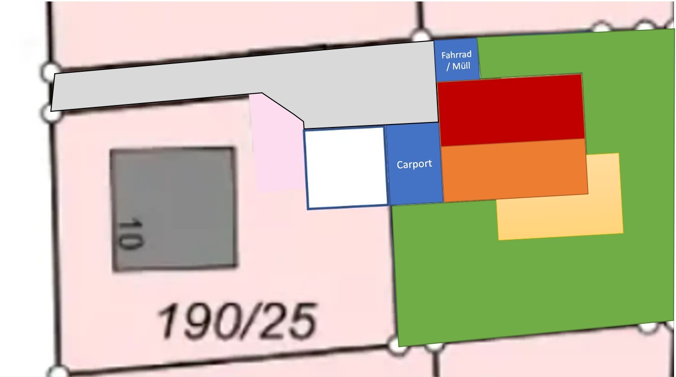

Or should the neighbor’s garage remain as it is, with the driveway from the west? Of course, the wall thickness of the garage and storage room should be a maximum of 17.5 cm (7 inches). With a prefabricated garage, it can even be thinner.
Grundriss eines Gebäudes mit pinkem Hintergrund; überlagerte farbige Rechtecke und Dachplan.
The house, however, should be 4 m (13 feet) away from the garage. Even better, 6 m (20 feet), so you can have two parking spaces and a bit more western orientation for the garden.

RomeoZwo1 Mar 2023 10:30
Or something like this...
Floor plan of a house with a carport, bicycle/waste area, and green garden.
I would also consider the gable orientation as "variable," unless it is meant to be optimized for photovoltaic panels?

That sounds reasonable. From our point of view, however, this is not necessary; we are planning with the 3m (10 feet) access road that belongs to us. The fact that the neighbor’s access is insufficient and he wants to share ours is a concession on our part. We have not been asked to formalize this contractually.
His house is shown on the site plan with plot number 190/25. He is renovating the existing building, not constructing new (currently in progress).

But why should the children’s rooms face west? A new house will be built quite close there. Both children’s rooms facing south (for example with dormers) offer a much nicer view. The bungalow to the south also looks quite new; the plot is divided, but used jointly, and I don’t expect that to change anytime soon. Also, access for a property behind would be difficult there. The beautiful and “private” side of your property will be the south and east (there are trees in front of the railway embankment).
My concept would therefore be children’s rooms facing south, bedroom probably northwest (ideally east, but how noisy/busy is the railway line?).
The railway line is only used once a day on weekdays (for waste transport to and from the transfer station at the harbor).

Hopefully, the original poster will share a Google Maps image with a wider view. Normally, I am a big fan of a "west" orientation, but here, especially considering the probably somewhat larger new building of the neighbor compared to the existing house, this will be the "blocked" side.
What does the north side look like? Is lot 173/5 going to be or already built on?

Okay, that changes a lot. Then it would also be an option to move the house as far east as possible to create a west-facing garden/terrace.
The houses to the north partly use the gravel road as an access; would that still be possible for you as well?

That sounds reasonable. From our perspective, however, there is no such need—we are planning with the 3m (10 feet) driveway that belongs to us. The fact that the neighbor’s driveway is not sufficient and they want to share ours is a concession on our part.
I completely understand your point, including the shape of your property, but honestly, the whole plan seems quite absurd.
You have 20m x 3m (65 feet x 10 feet) next to exactly 20m x 2.5m (65 feet x 8 feet) at the neighbor’s place, both driveways “concreted over” right next to each other in parallel.
If a proper right of way had been arranged here, everyone would have benefited—especially when it comes to reducing impervious surfaces.
