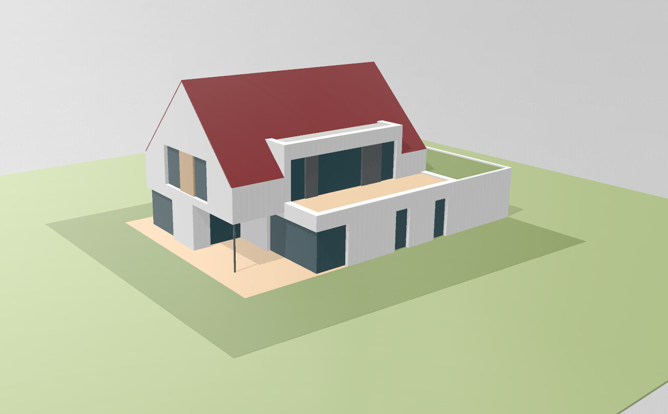

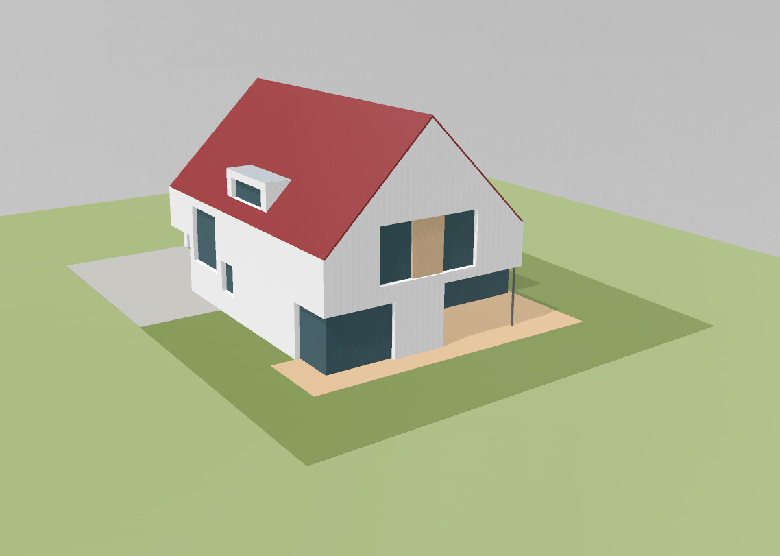

Hello housebuilding forum members,
I enjoy reading this forum and would like to share our planning for discussion. Our plot is designated as parcel number 173/6.
Plot size: 498 m² (driveway approx. 60 m² (645 sq ft))
Slope: No
Site coverage ratio: No development plan (§34 Building Code)
Floor area ratio: No development plan (§34 Building Code)
Building envelope, building line and boundary: 3 m (10 ft) from plot boundary according to Bavarian Building Regulations
Edge development: none
Number of parking spaces: 1
Number of floors: 1.5
Roof type: Gable roof with a pitch of 40-45°
Architectural style: Single-family house
Orientation: Ridge line East/West
Placement on the plot: Northwest
Maximum height / limits: approx. 9 m (30 ft) (§34 Building Code)
Immediate neighbors: North neighbor 1.5 floors with gable roof. South neighbor single floor with hip roof. West neighbor 1.5 floors with gable roof. Next-nearest neighbor south 1.5–2 floors with gable roof and knee wall >1.2 m (4 ft).
Owner’s requirements
Style, roof type, building type: Gable roof, knee wall 1.4 m (4.5 ft), single-family house
Basement, floors: Usable basement (concrete), ground floor, upper floor
Number of people, age: 4 (2 adults + 2 toddlers)
Room requirements on ground and upper floors: Ground floor (kitchen, living room, shower bath, wardrobe, office), upper floor (2 bedrooms, 2 children’s rooms, bathroom)
Office: Home office
Guest bedrooms per year: 0
Open or closed architecture: Tending rather closed
Conservative or modern construction: Modern
Open kitchen, kitchen island: Yes, no kitchen island
Number of dining seats: 6–8
Fireplace: No
Music/sound wall: No
Balcony, roof terrace: No
Garage, carport: Garage or carport
Additional wishes / special features / daily routine, also with reasons why some features are wanted or not:
Planner:
- Do-it-Yourself
What do you particularly like? Why?: Shower niches in the bathrooms, large children’s rooms facing west, L-shaped living-dining area instead of a narrow layout
What do you dislike? Why?: Upper floor bathroom, office located in the southeast instead of northwest
Cost estimate according to architect/planner: 580,000 EUR
Personal price limit for house including fittings:
Preferred heating technology: Air-to-water heat pump with underfloor heating.
If you had to give up, which details / extensions
- could you give up:
Office on ground floor (if replaced by usable basement space)
- could you not give up:
4 bedrooms
Requirements and many attempts with our furniture. As much garden as possible on the south and east sides.

derdietmar1 Mar 2023 22:20Hello,
a beautiful plot in a rare location. It would be a shame not to take advantage of the location’s benefits:
Ground floor:
If one of the children’s rooms can be used as an office, a basement is not necessary. The office on the ground floor will be converted into a utility/technical room.
- Secluded from the road, private entrance
- No building allowed to the east
- View of the canal or towards Erlangen from the upper floor (the railway embankment is about 3 meters (10 feet) high)
Ground floor:
- Entrance northwest
- Office northeast
- Guest WC west
- Kitchen east
- Dining southeast
- Living southwest
- Children’s bathroom northwest
- Bathroom west
- Master bedroom southwest
- 3x children’s rooms northeast, east, southeast, all with access to the roof terrace

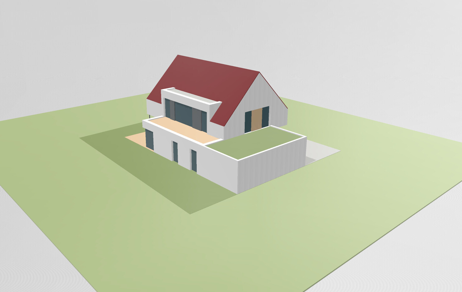

Hi, here is the creator of the plan 🙂.
Before my better half responds, I would like to share some background on the thought process behind it.
Orientation and layout:
First of all: the south is not guaranteed to remain unobstructed. In fact, the bungalow is roughly the same age as all the houses around it. It is quite possible that a house will be built on the neighboring property behind the bungalow. Direct car access wouldn’t even be necessary. There are ways to address that separately. It’s actually fairly likely that a house will be built there eventually, since property prices in this area are so high that such lots are usually not sold as complete units. Hardly anyone can afford the land costs here. So the free, unobstructed view to the south is not as certain as assumed here. If or when a house gets built there, we don’t know yet, but I wouldn’t be surprised.
There is also a version of the plan where the house is rotated, with the ridge running north-south. In that layout, the children’s rooms and living/dining area face south, the kitchen is east, and the office is northeast, etc. That’s nice too, but then we measured the plot with tape and string, and there simply wouldn’t be enough space on the south side if someone were to build their house just 3m (10 feet) from the boundary. That’s why I rotated it—to gain a bit more distance there.
It might also be important to know that there are quite a few trees along the railway line to the east, and because of the elevated position, the sun doesn’t arrive until relatively late.
House size:
We know that neighbors had issues getting approval for the size, knee wall height, etc., even though their architect believed it fit the regulations. The size of this design was based on the buildable footprint that neighbors were finally approved for after long negotiations. I also contacted the city’s building authority to check compliance with building regulations regarding dimensions and similar details. We received a response indicating that it fits in. Although it’s not legally binding, it is at least a good first indication.
Basement:
Yes, the basement is explicitly needed. There are no pointless rooms there; the statement was only that we haven’t yet decided how to divide it. Using and needing the space is beyond question.
Office:
The office will be full-time workspaces. I would even say this will be the most used room in the house on weekdays outside of vacation periods, which is why the orientation had to be carefully considered (and was).
Living/Dining/Kitchen:
I find a narrow rectangular layout awful and absolutely do not want one. Also, no closed kitchen. That pretty much leaves only an L-shape layout, which then has to be placed cleverly 😉. The alternative would be to mirror the entire thing so the kitchen is in the northeast, but then the office would be southwest, and the entire living area wouldn’t get any light from the west. Plus, the staircase would have to move further west, unnecessarily enlarging the upstairs bathroom.
Upstairs bathroom:
Yes, it’s not very large, but it doesn’t need to be. I grew up in a house with a 12sqm (129 sq ft) bathroom, and apart from having enough room to lie in the middle, it didn’t offer any significant advantages. The cut-out with the "laundry basket tower" was more of an idea. I’m also convinced that something like that behind the door would be a pretty cool storage space. What is true, though, is that the height from the step to the ceiling is 2m (6 ft 7 in)—that should be increased. Also, 1.2m (4 feet) depth is simply too much, and the wall thickness is 0.21m (8 inches). The internal dimension of 0.45m x 0.65m (18 in x 26 in) seems feasible, also considering headroom by the stairs. But somewhere there has to be space for something like a laundry basket. The second bathroom downstairs has the bathtub, because we simply don’t use it often. I don’t see any real sense in making the bathroom bigger just to fit an item that’s rarely used. There is enough space for that downstairs.

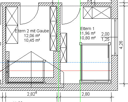

Master bedroom:
I think it was already mentioned: the smaller room, so parents’ bedroom 2, will get a dormer, and the room will gain 30cm (12 inches) more space from parents’ bedroom 1. These won’t be needed if a 1.5m (5 ft) wardrobe fits there. Something along those lines—the walls at the dormer would of course not have any overhangs, etc. It’s not huge, but it doesn’t need to be. It’s for sleeping and dressing, and in about 20 years at the latest, the larger rooms will be ours 🙂
Overall, the plan was created by thinking about how we use and move through spaces. I also considered what I/we find important. For example, someone wrote that new builds should have double-leaf terrace doors. In my whole life, I have never thought a single-leaf terrace door is unwelcoming or wished there was a double door instead, not at relatives, friends, or homes where I’ve lived. Also, the lack of terrace access from the kitchen is often criticized. I have never thought much about that, so it wasn’t a high priority. In daily life, that’s a minor issue compared to, for example, a narrow rectangular layout or a separate kitchen. I just don’t like those.

Master bedroom:
