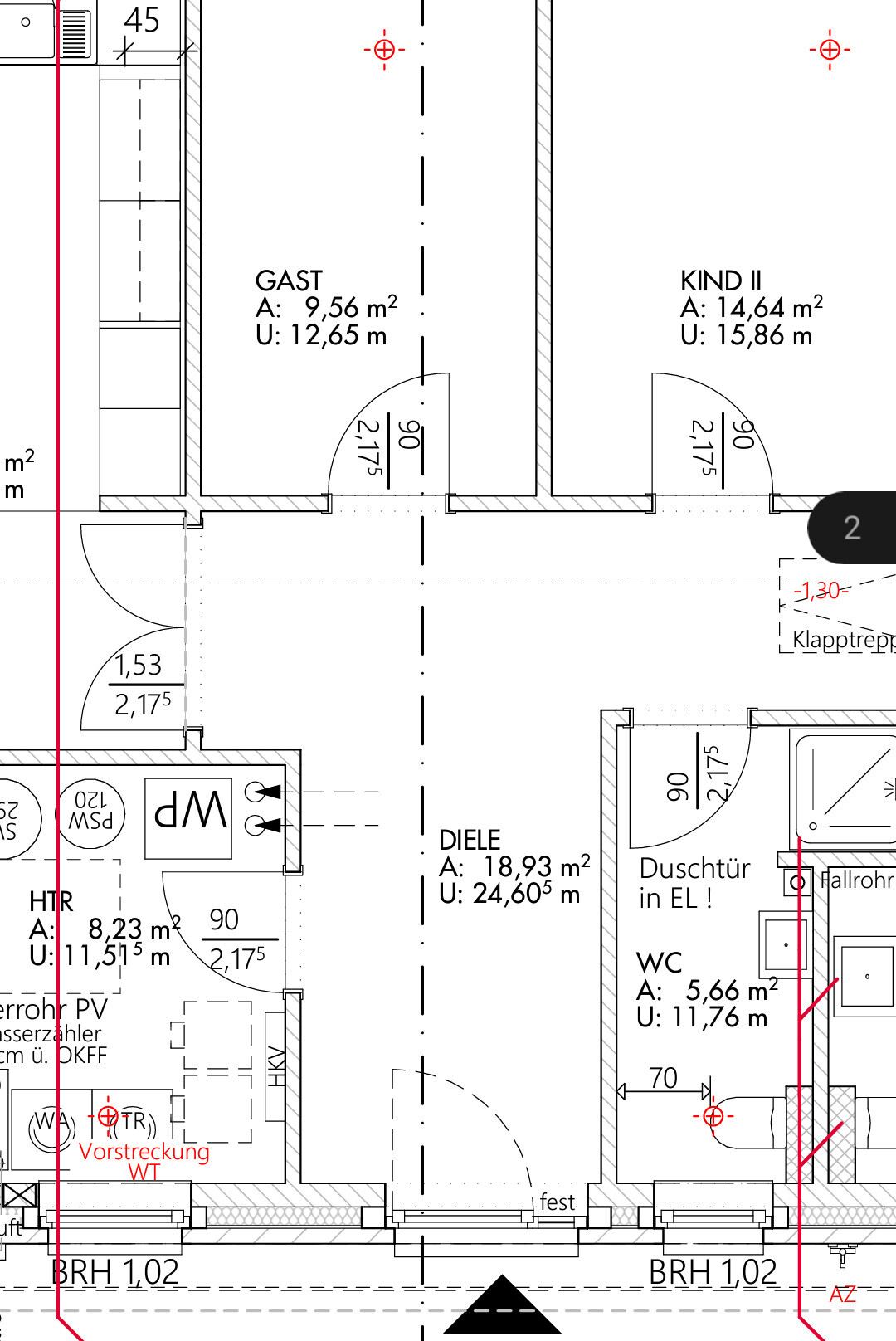

Hello! I would like to share our plans with you and would appreciate any suggestions or improvements, more specifically further down. First of all:
- Plot size: 707 sqm (7,609 sq ft)
- Slope: no
- Site coverage ratio: -
- Floor area ratio: no development plan, same as neighboring buildings
- Building window, building line and boundary
Edge buildings: 3 m (10 ft), building encumbrance considered
- Number of parking spaces: 2
- Number of storeys: 1
- Roof style: hipped roof
- Architectural style: bungalow
- Orientation: driveway on the south side, terrace on the north side
- Maximum height / limits: -
- Other requirements: -
Owners’ Requirements
- Style, roof type, building type
Small but cozy floor(s) 😉 No stairs (for husband), bungalow / country house style, no basement, attic not usable
- Number of people, age: 2 adults, 2 children (2 and 5 years old)
- Space requirement: 140 sqm (1,507 sq ft)
- Office: family use or home office: both teachers, so necessary, but one desk is enough
- Overnight guests per year: grandmother often (about every other weekend), otherwise irregular visits from friends or family members
- Open or closed architecture: both
- Traditional or modern construction: both
- Open kitchen, kitchen island: yes, already purchased
- Number of dining seats: 6
- Fireplace: no
- Music/sound system wall: no
- Balcony, roof terrace: no
- Garage, carport: carport planned later
- Utility garden, greenhouse: children’s play equipment, some garden for vegetables, more of a natural garden
- Additional wishes / special features / daily routine, including reasons for choices: our plot is quite narrow; a bungalow was our dream and fits well on the lot, although it is quite far from the driveway and parking spaces. We prefer a country house style; the house will have red facing bricks with an anthracite-colored roof. We all spend a lot of time on hobbies and gardening in the afternoons, but the children also want their fun... The large building to the east on the neighboring plot will soon be demolished and replaced by three large buildings with senior apartments. The distance to us will then increase somewhat, but these are three storeys and part of our street will be used. So there are quite a few changes happening around here. The village has many supermarkets, a drugstore, an outdoor pool, and schools, but no train station or grammar school. Those are located in the nearest larger town (15 minutes by bus/car).
- Who designed the plan: planner from a construction company with us
- What do you particularly like? Why?
The layout, bathrooms, separation of living and sleeping areas, open kitchen
- What don’t you like? Why? Possibly too little space in the utility/technical room and for storage cabinets?
- Price estimate according to architect/planner: Plot 80,000, house price 321,000 without flooring and painting but tiled in kitchen, baths and utility room, we signed in April 2022 and financed at the same time, rural Lower Saxony plot but located between three large cities, additional costs for the plot paid so far 16,500 (property taxes, tree removal, surveying...), planned further 30,000 for construction road, extra cost for deeper excavation, drainage. Kitchen (Bristol style) from Häcker in L-shape with island already purchased and stored, 14,000 Euro as it is a display kitchen and only slightly modified.
- Personal price limit for the house including fixtures and fittings: flooring 5,000, painter, electrician, tiles... 10,000, kitchen 14,000, furniture included, new sofa 1,000 and a few new cabinets: approx. 360,000 Euro without exterior works and additional costs.
- Favored heating technology: we are installing geothermal heat
- If you had to give up some details or fittings, which ones? I think we have already given up on a lot of unnecessary things. Carport for now
- Things you can’t do without: open kitchen, children’s bathroom with shower, shutters on the south side
- Why is the design as it is now? Developed together with planner
- Which wishes were implemented by the architect? Bungalow, children’s room 14 sqm (150 sq ft), children’s bathroom with shower
- What do you think makes it particularly good or bad? Everything on one level, wishes were implemented, possibly too little space for stuff?
We like the floor plan as it is and have already obtained building permit/planning permission for it. I would like to know if the space in the utility room is sufficient and if there is enough space for cabinets. We currently live on 73 sqm (785 sq ft) and have rather little; even the basement only stores a bit of Christmas decoration, children’s clothes for the younger one to grow into, and my husband’s workshop items, which will eventually go into a shed/workshop. The children currently share one room (11 sqm (118 sq ft)). If it is then split into two rooms in the house, that should be plenty. Still, there is sometimes some concern since many here plan much larger and allocate more storage space...
Would you change anything else or are we overlooking something? We have no load-bearing walls and could still make some adjustments before construction starts (even if it costs more).

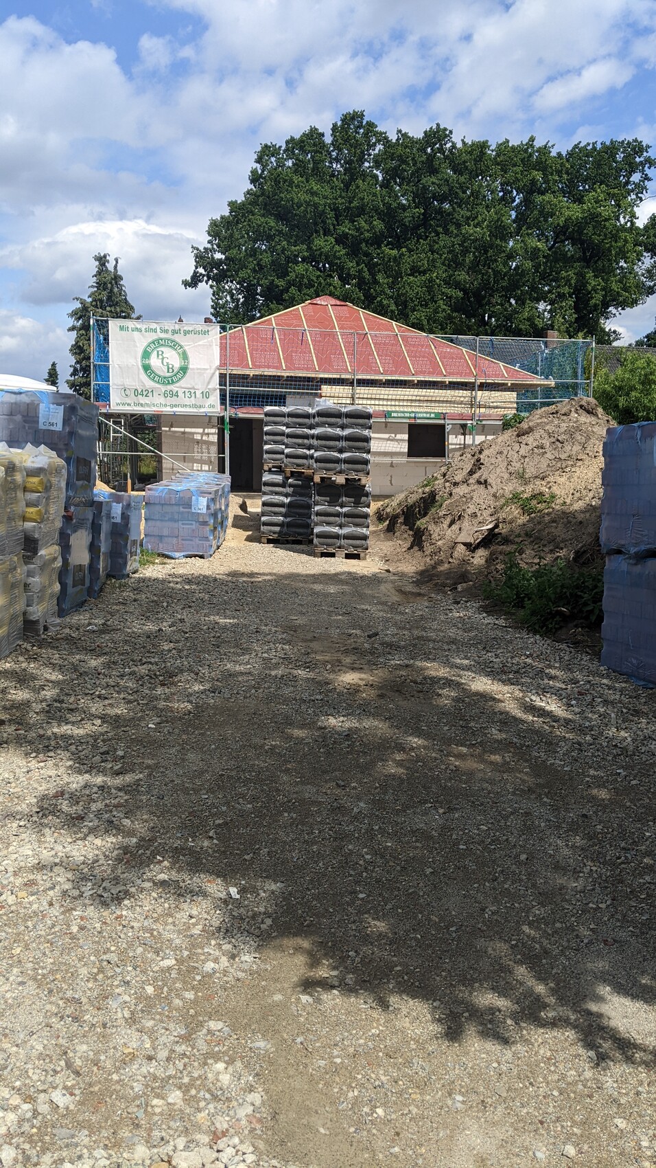

EinmalimLeben20 Jul 2023 12:59Hello!
We are now at the roof stage and had our topping-out ceremony on Monday evening! Everything is going smoothly so far, and we are making good progress. We spend a lot of time on the construction site, although we are complete novices. Our building supervisor is very helpful and regularly checks that everything is running properly. We are very happy with that decision, even though there haven’t been any major defects so far.
We have now chosen the tiles and are taking care of the “remaining” flooring in the bedrooms and living area. Originally, we wanted hardwood flooring, but laminate would probably be more affordable and practical with children.
We definitely don’t regret the attic trusses! It’s already clear that they have freed up plenty of storage space!
I’m a bit annoyed about the bedroom window. It somehow seems pointless.
EinmalimLeben schrieb:
I'm a bit annoyed about the bedroom window. It somehow felt pointless.??? I actually really like my bedroom window, and I had one in my previous apartments as well 🙂https://www.instagram.com/11antgmxde/
I'm a bit annoyed about the bedroom window. It somehow feels pointless. We even have a large double casement patio window/door. We wouldn't want to be without it anymore.
E
EinmalimLeben22 Jul 2023 15:48Yes, I meant the second window, which is too much. We already have a patio door in the bedroom as well.
