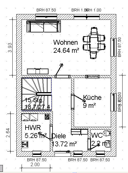

we have been planning our semi-detached house for a few weeks now and have reached a point where we are quite satisfied with the design. We would like to know if our layout makes sense.
We are somewhat unsure about the arrangement and size of the toilet, utility room, and cloakroom. Also, we wonder if the 135° angle at the kitchen corner really makes a difference… it is supposed to make the hallway look "nicer."
The house is planned in a minimalist style, but in my opinion, it is still spacious enough for a family of three.

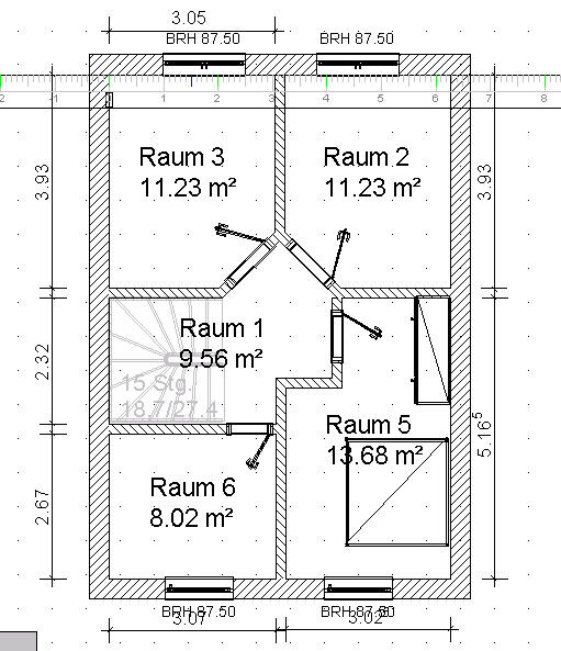

The attic is not yet developed, so the floor plan for the top floor is not relevant for now.

You should get the maximum out of your minimum area. You have a nice southwest-facing location, so that should be an advantage. Say goodbye to a huge hallway and limit yourself to an entrance area/coatroom. With one child and no basement, you can design the staircase open, for example in the dining area, it doesn’t need to connect to a corridor!
In the bathroom, you can do without the T-layout; a simple arrangement of the sanitary fixtures looks more elegant and spacious than adding extra walls in the bathroom.
I would be interested in seeing the floor plan from the builder!We currently have an open staircase, and our child often complains that we are too loud. That’s why we are trying to separate the living room and the stairs.
We are happy to do without the T-version in the bathroom. I just thought the idea of separating the shower and toilet was brilliant.

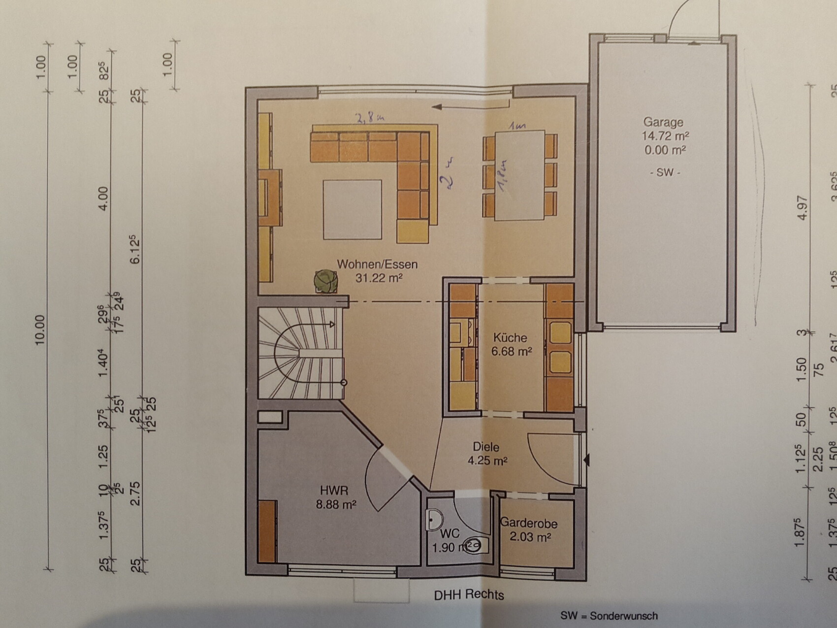

Primarily, my budget matters. Then practicality. Then aesthetics and luxury.
Attached is the initial plan from the general contractor and the ground floor layout with furniture.

I think if the entrance is placed at the front, the toilet will be to the right of the entrance and the utility room will be larger. The hallway will then be straight and much brighter. The utility room will now be somewhat smaller, but more practical because it is rectangular.
