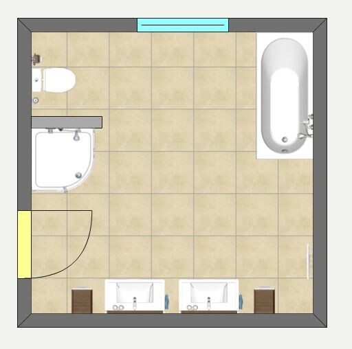

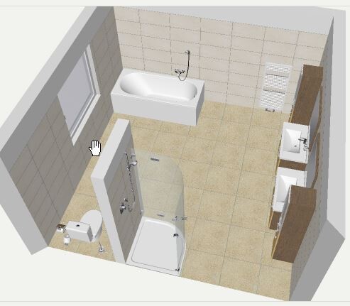

The extra small bathroom will be removed. It takes up too much space. It will probably look something like this (bathtub 1.80 m (5 ft 11 in) in length, knee wall above the window side 2 m (6 ft 7 in)).
Best regards!
My wife has already been a strong advocate for "her" workspace and is now happy to have more arguments in favor. So, the room sizes will stay as they are.
Best regards!
There are also some small guidelines to consider in the bathroom. For example, placing the window to the left of the sinks so that right-handed people get suitable natural light. You could build a wall and place the shower behind it. Radiators should be next to or near the shower. Do you absolutely need a privacy screen next to the toilet?
