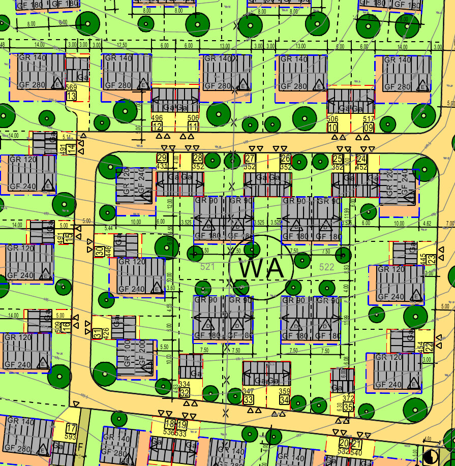

I haven’t fully understood this point yet. The ground floor area is 90m² (7.50 x 12m). But what does GF 180 mean in this case? Am I allowed to build a maximum of 2 full storeys with 90m² ground floor area each?

I haven’t fully understood this point yet. The floor area is 90m² (970 sq ft), 7.50 x 12m (25 x 39 ft). But what does GF 180 mean in this case? Am I allowed to build a maximum of 2 full stories, each with a floor area of 90m² (970 sq ft)?
Sorry, my answer should make it clear that the details in your drawing are rather unusual.
Who sets the 90 m² (970 sq ft) limit here? Usually, there is a setback requirement of 3 meters (10 ft), not 3-point-something. And there are two factors that limit the floor space index and the floor area ratio.
What are the blue lines? Building envelope/planning boundary?
Maybe @Escroda knows. [emoji2]

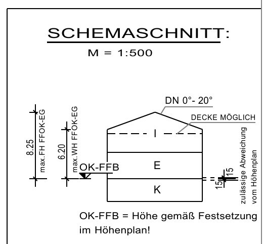

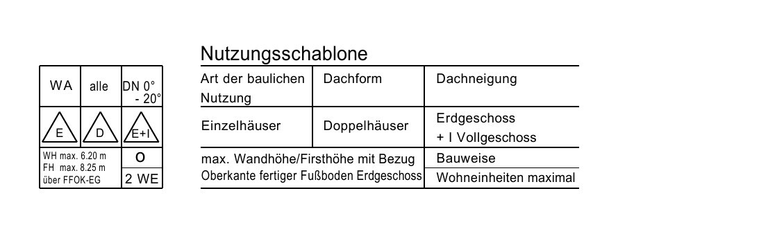

Here are some additional details that might help.
Thanks in advance for the great information :-)

11ant16 Jan 2018 14:16
Dre87 schrieb:
The rest can be seen in the development plan excerpt, which also shows our plot
I would rather call this excerpt a "little snippet," as it does not reveal much.
By the way, the building envelope stands alone in the middle of the forest without any further explanation.
The building zone for this plot is clearly very limited in width (7.50 m (25 feet)), and the depth is only indirectly defined by the floor plan (exactly 90 sqm (970 sq ft)). Only if you insert a perfectly rectangular shape does it practically result in a building depth of 12 m (39 feet).
The schematic drawing mentioned in post #16 is missing, so I cannot verify my speculation about the setback floor. Based on the 90 sqm (970 sq ft) floor plan and 180 sqm (1,940 sq ft) gross floor area, one could infer (with about 72 to 76 sqm (775 to 820 sq ft) of usable floor area per full floor) a possible setback floor of 28 to 36 sqm (300 to 390 sq ft). That would really only be enough for one bedroom, since a roof terrace is also considered. Maybe the office goes upstairs instead?
A plot size of 353 sqm (3,800 sq ft) here would effectively correspond to a site occupancy ratio (building footprint ratio) of 0.25 and a floor area ratio (FAR) of 0.5, which are actually not bad figures.
My question
What exactly does this mean: no catalog design or no timber panel construction?
has so far remained unanswered.

The building area for this property seems to be strictly limited in width (7.50 m (25 feet)) and only indirectly limited in depth through the floor plan (a maximum of 90 sqm (970 sq ft)). Only if you place a perfectly smooth rectangle there does it practically result in a building depth of 12 m (39 feet).
The schematic drawing mentioned in post #16 is missing, so I can’t verify my speculation about the setback floor. From the 90 sqm (970 sq ft) floor plan and the 180 sqm (1,937 sq ft) total floor area, you could have a possible setback floor of 28 to 36 sqm (300 to 390 sq ft), assuming roughly 72 to 76 sqm (775 to 820 sq ft) of floor space per full floor. That would realistically be enough for only one bedroom, since a roof terrace is also part of it. Maybe the office could be placed upstairs instead?
A 353 sqm (3,800 sq ft) plot here would practically mean a site occupancy index (building coverage ratio) of 0.25 and a floor area ratio of 0.5, which are not even bad values.
By the way, my question is still unanswered.
I forgot to give the answer here ;-)
We want to build with solid construction (not a prefab house) and be individual. However, in the end, it will probably be one of the many examples you find on the internet or at least very similar.
Attached is a larger excerpt; we have the 27.
