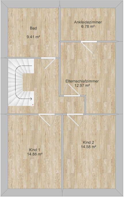

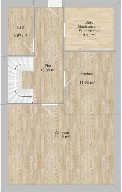

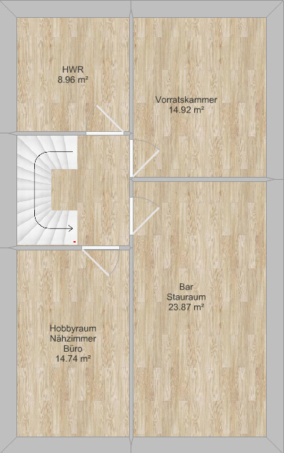

I have created new floor plans, which are still quite similar to the previous ones.
I’m not making much progress in figuring out a better way to lay everything out.
The staircase is probably best positioned facing the other semi-detached unit, right?
I haven’t included windows or similar details in these plans.
I’m having trouble finding a better way to divide the width.
The goal for the upper floor is 1 master bedroom and 2 children’s rooms plus 1 slightly larger bathroom.
On the ground floor: 1 guest room/office, kitchen, living area, and a small bathroom.
In the basement: 1 storage room/pantry, 1 office/sewing room, and 1 hobby room/entertainment room.

I would switch the walk-in closet and the master bedroom so that you enter and exit the bedroom through the closet.
Additionally, I would personally make sure that no bedrooms share a party wall. With these "uncoordinated" semi-detached houses, you hardly know what’s happening just an arm’s length away.
