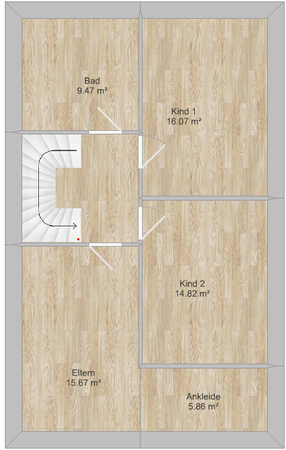

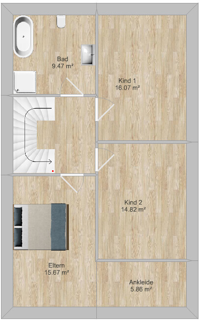

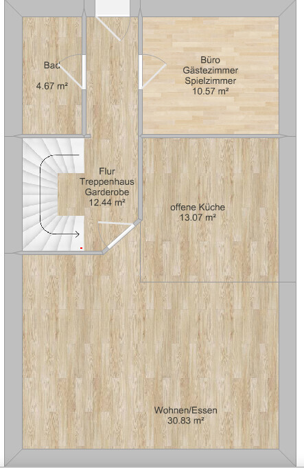

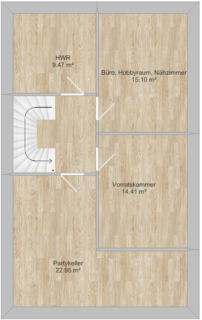

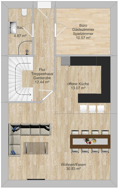

I have now created a floor plan without an attic (I only read about that afterwards :-) ). Maybe some of you have a few tips on this, as I’m a complete beginner in this field.

What I notice:
Hallway
From my perspective, it’s a disaster. Long and narrow. You’ll bump into each other while getting dressed, and there’s not really enough space for a coat rack. The space under the stairs will quickly be used up.
Living Room
It’s not my taste to see the back of the sofa. We had that in our old apartment, and somehow it always looked... makeshift.
Guest Bathroom
Does the guest bathroom really need a shower? Or would just a toilet be enough, giving you some extra space for the hallway?
Master Bedroom
I would swap it with the upstairs children’s room and then shift it slightly downward (you can still have a walk-in closet). That way, you’ll have a shorter path to the bathroom. The kids have young legs, and you’ll live in the house longer than they will. You can still place the doors there; it gives the rooms a slight offset, which I always like because it breaks up the “square, practical, good” look a bit.
Hallway
Living Room
Guest Bathroom
Master Bedroom
