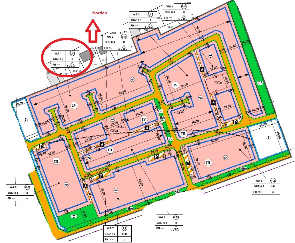

Escroda schrieb:
She made use of §3 for this, for your area WA1 under point 3. Specifically, this means: you do not need to include the access path to your house in the plot ratio (Grundflächenzahl I).
Does this only apply to “cul-de-sac plots”? Do all other plots not benefit from this?

Apart from the restriction of "state," I agree with that. And there isn’t really any consensus on the access roads either, which still leaves some room for interpretation. Thank you, Escroda, for the clarification. At what level is it decided what counts towards the floor area ratio (FAR)? Can this vary from municipality to municipality?Garlintor schrieb:
Does this only apply to "pipehead plots"? All other plots don’t have this? Yes.
Garlintor schrieb:
So only 17m² (180 sq ft) remain for the garage, terrace, and paving? No. 17m² (180 sq ft) is allowed for the terrace, as it counts towards the main development area, i.e., the site coverage ratio I.
The areas of garages, parking spaces, and driveways are permitted to exceed the site coverage ratio by 50%, up to 0.45, which corresponds to a buildable area of 249.75m² (2686 sq ft) on a 555m² (5972 sq ft) plot.
