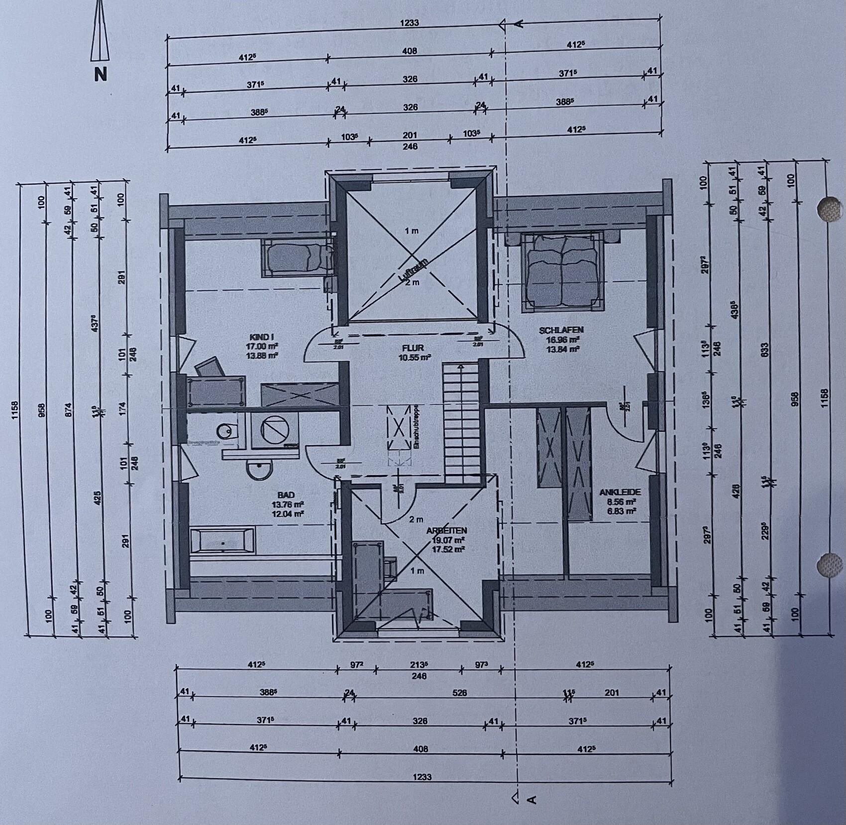

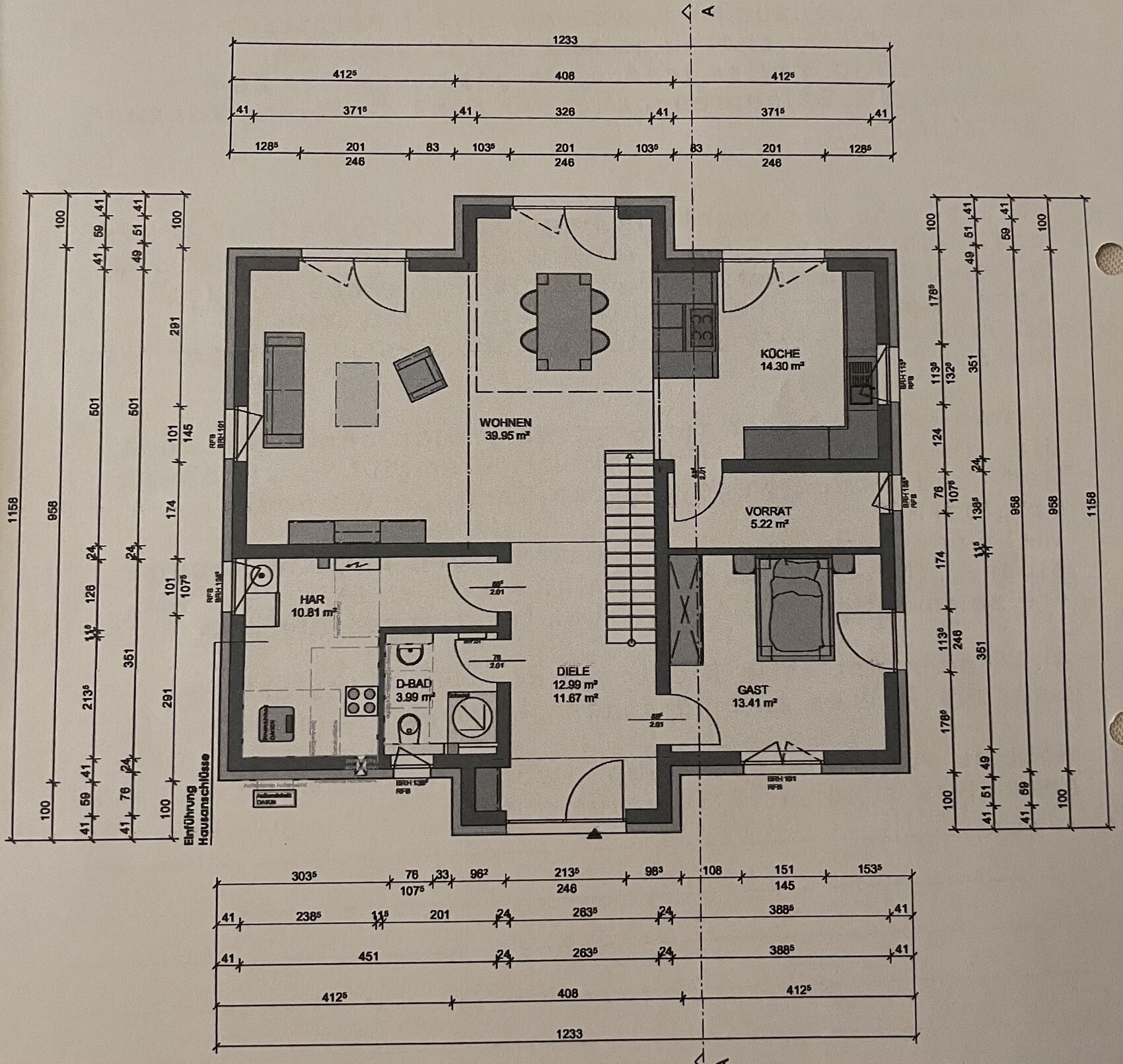

I’d like to bring this thread back up. We have now received the preliminary floor plans from the architect.
We are generally satisfied, but the utility room (HAR) and the guest room (office 2) will be swapped so that the utility room becomes larger.
The entrance faces south, and the living room is on the north side. Unfortunately, this can’t be changed because the view on the north side is very nice.
The double garage with storage room (6m x 9m (20 ft x 30 ft)) will be placed to the right of the house, set back slightly with a 1.80m (6 ft) distance. The terrace will be located behind the living/dining area and wrap around the left corner to catch the southern sun.
What I’m still not 100% happy with is the upstairs office. Do you have any comments or suggestions for improvement?

I think the ground floor layout is quite good. For me, it feels a bit too open. I would consider adding a glass door between the hallway and the living area, so that wind doesn’t blow straight through the entire house when the front door is opened. Also, this would help to prevent noise from the ground floor from traveling freely to the upper floor.
For this reason as well, I would leave out the open atrium space. Honestly, I don’t really understand the purpose of such an open atrium. The steam and smells from the kitchen would go directly up to the upper floor.
Instead of the atrium, the second office or guest room could be placed upstairs.
The walk-in closet could possibly be rotated 90 degrees. The room behind it could then be used as storage, accessible from the office.
As it is now, I don’t find the walk-in closet very practical.
Thank you for your feedback. Your point about the walk-in closet is a good one, and I will review it again with the architect. We like the open space and want to keep it. However, you are of course right that this open design allows odors and sound to travel to the upper floor.
