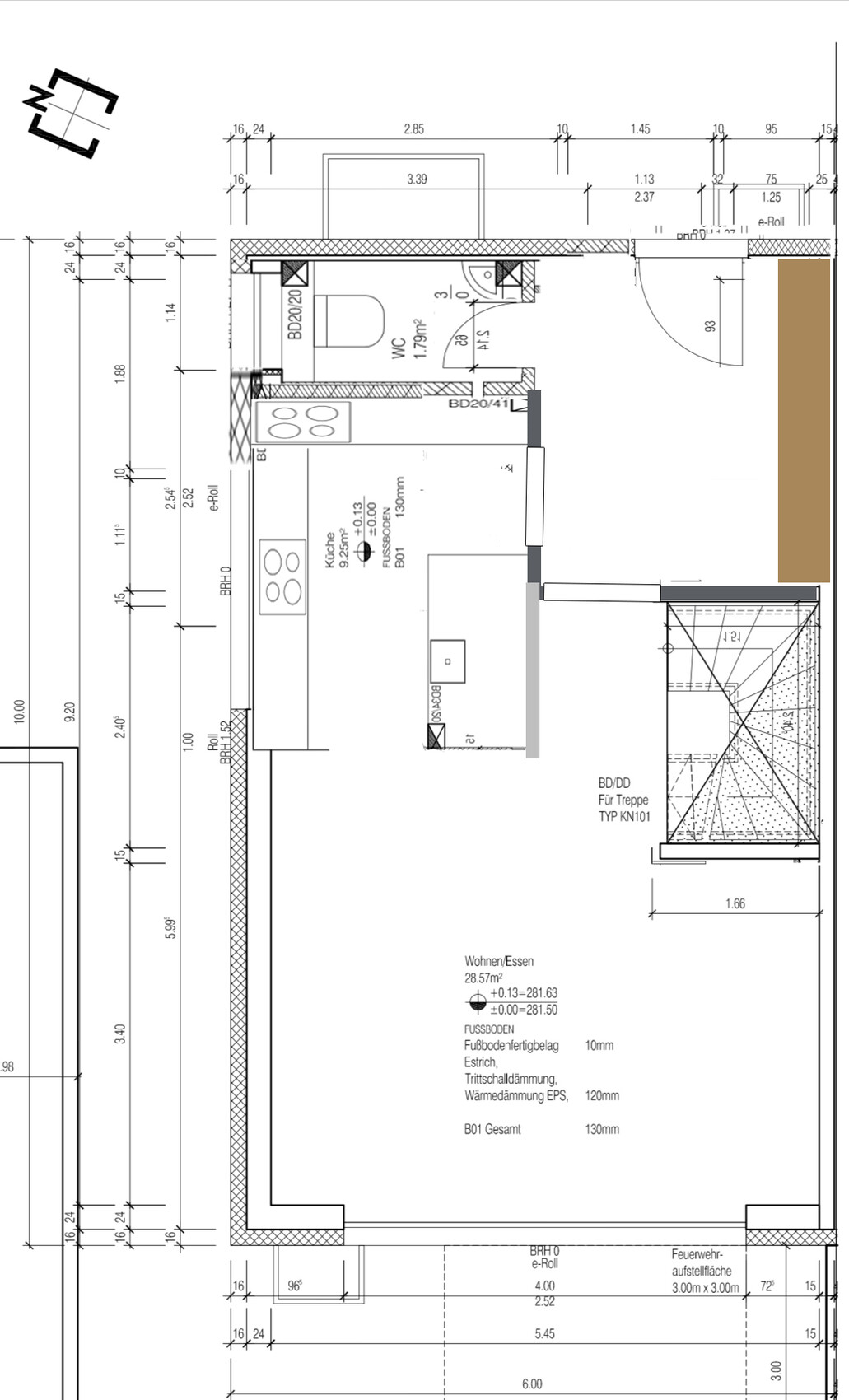

kaho67422 Nov 2018 10:58
MelleL schrieb:
irgendetwas must be done eventually
With a house of this size, unfortunately yes. Maybe someone else has ideas. But for me, it comes down to choosing between the hallway door and kitchen size. 🙂
I think the kitchen will win. 😀
J
j.bautsch
22 Nov 2018 11:07
For me, the kitchen would also be the winner. After all, you tend to spend more time there than in the hallway 😉
MelleL
22 Nov 2018 11:08
Same here! Especially considering that I’m already “done” with the kitchen planning. Nothing would change except that the water connection would need to be rearranged. The extractor hood’s ventilation would then be routed through the floor, out of the basement window, as in an earlier plan when the cooktop was still on the island. We found that solution better from the start, so there is no visible drilling on the house wall.
And please excuse the terrible spelling mistakes... I think my phone is working against me!?
kaho67422 Nov 2018 11:13
MelleL schrieb:
Same here! Especially considering that I am "finished" with the kitchen planning. Nothing would change except the water connection would have to be redesigned.
Um, unless you want the larger version..., which j.bautsch and I were referring to...
MelleL
22 Nov 2018 11:38
Of course, I would like everything, hahaha. That’s how we women are. The larger kitchen would be great! But I find it quite odd when guests come and have to walk through the kitchen and living area. And I myself would also find it strange to always walk through the kitchen... It would be fantastic, of course, if the passage from the living area to the kitchen were enlarged and groceries could be brought directly from the hallway to their destination.
But I need to think about it a bit more...
kaho67422 Nov 2018 12:11
It’s also a question of whether you consider yourself a top chef. Some people buy a huge kitchen and then end up ordering pizza all the time.
I wouldn’t mind having a small kitchen in a small house. However, we only cook on weekends and there are just two of us.
“Both” could work, like Yvonne suggested by rotating the kitchen. That would also be one of my favorites. The window would then have a standard sill height but be nice and wide, with tall cabinets against the wall next to the WC. How far the kitchen extends into the living area would need to be carefully considered. Small cooks get smaller kitchens, big cooks get bigger ones. 🙂
It would also be helpful to know the rest of the furniture layout.
