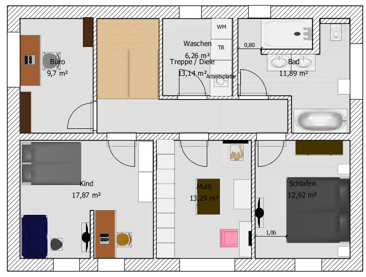

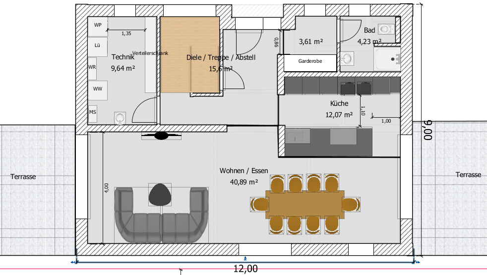

ᐅ Floor Plan Design for a Single-Family Home, 160 sqm, Narrow Lot
Created on: 17 Oct 2023 14:34
E
ExzitonDevelopment Plan/Restrictions
Plot size: 667 sqm (7,178 sq ft); Width = 16 m (52 ft)
Slope: Yes, 2 m (6.6 ft) over a width of 16 m (52 ft)
Site coverage ratio: §34
Floor area ratio: §34
Building window, building line and boundary: §34
Edge development: No
Number of parking spaces: Yes
Number of floors: 2
Roof Type
Style: Gable roof
Orientation: South azimuth +20°
Single-family detached house
No basement, number of floors: 2
Number of occupants: 3, including 1 child
Space requirements on ground and upper floor
Office: Home office
Open architecture
Modern construction
Open kitchen with island
Number of dining seats: 6–10
Fireplace: No
Terraces on the gable sides
Designer:
- Do-it-Yourself; original design by a construction company slightly modified
What is not liked? How could a pantry be reasonably integrated on the ground floor?
Estimated cost according to architect/planner: 400k
Preferred heating system: Heat pump
If you have to omit certain details/upgrades,
- Can be omitted: Garage will be built later; basic KNX system prepared and will be added step by step
- Cannot be omitted: Large walk-in closet as a multi-use room
Number of floors: 2
Roof Type
Style: Gable roof
Office: Home office
Open architecture
Modern construction
Fireplace: No
Designer:
Exziton schrieb:
How could a pantry be sensibly integrated into the ground floor?Under the stairs (?)Exziton schrieb:
-Do-it-Yourself; the original design by a construction company was slightly modifiedWhat were the modifications and their reasons? The original design and especially dimensions would be helpful.https://www.instagram.com/11antgmxde/
What were the adjustments and their reasons? The original design and especially the dimensions would be helpful.11ant schrieb:
What were the adjustments and their reasons? The original design and especially the dimensions would be helpful.A storage closet will be located under the stairs.
kbt09 schrieb:
And a site plan showing the house on the property including a north arrow. Also, where does the slope come into play?North is at 11 o’clock. The slope is at the bottom but will be supported by a retaining wall.
Something still doesn’t add up, the plot is 16 m (52.5 ft) wide, the house is 12 m (39.4 ft) wide, and there are terraces on both sides.
Is there a plan with contour lines?
Exziton schrieb:
Plot size: 667 sqm (7,178 sq ft); width = 16 m (52.5 ft)
Slope: yes, 2 m (6.6 ft) over a width of 16 m (52.5 ft)
Exziton schrieb:
The slope is at the bottom. It will be retained with a retaining wall.
