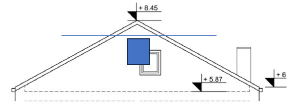

Can’t the gable window be centered?

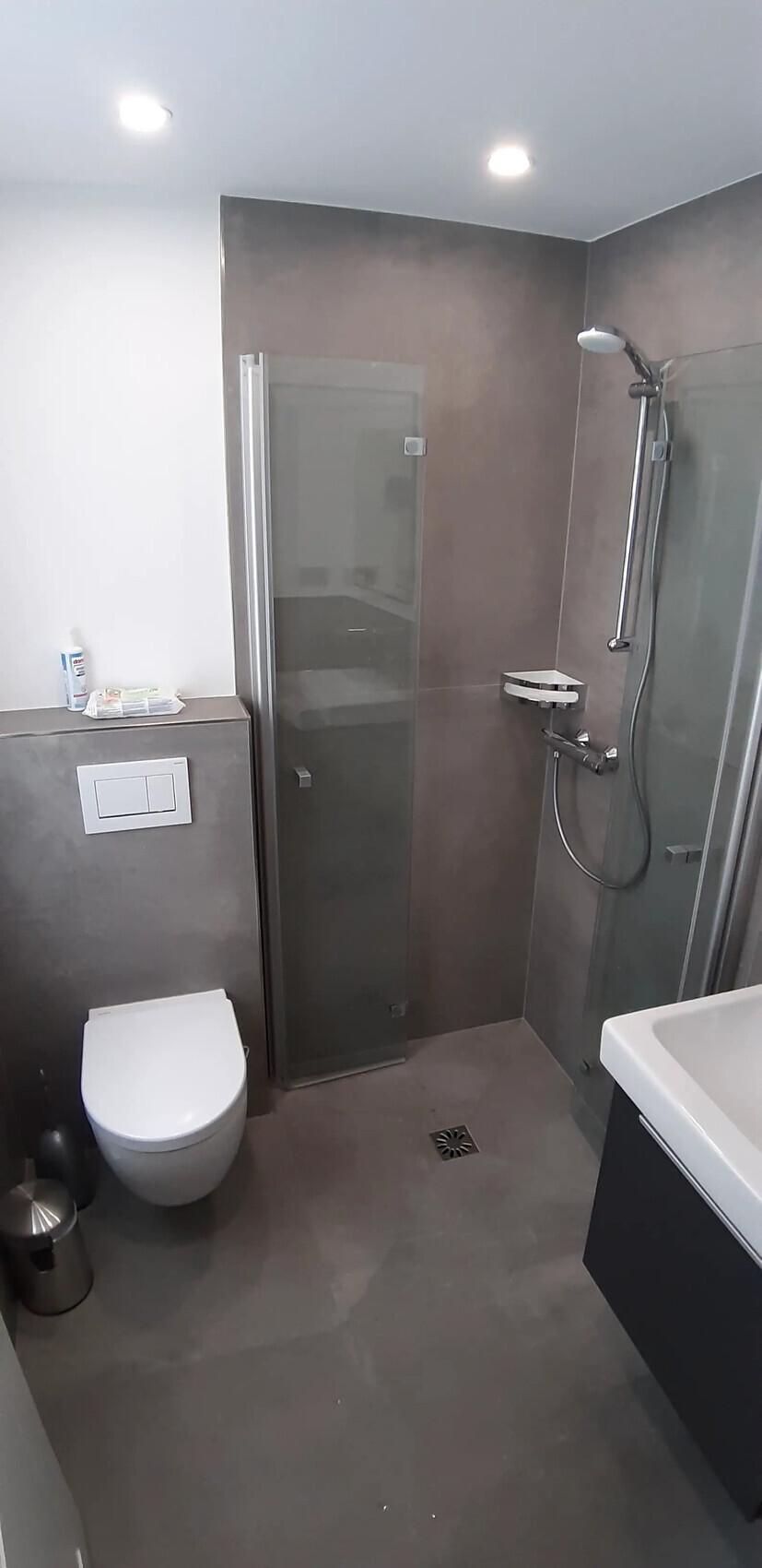

Here’s another version with a shower on the ground floor. Thanks, it looks very good 🙂. I told the architect to position the window in the ground floor WC facing east 🙂
Yes, I would also like a gable window in the middle. We have a nice view of the whole city to the south (beyond the neighboring house), and I hope to have a view from the children’s rooms and the attic.

hanghaus202318 Jul 2023 10:46You will hardly be able to use the attic. A standard staircase won’t fit there.
Here is a diagram with a 2 m (6 ft 7 in) line

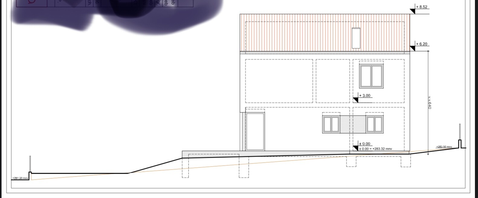

Please show us a photo of the view. An aerial photo of the surroundings would also be nice so we can get a better idea. Then I can also understand the suggestion for a balcony.

hanghaus202318 Jul 2023 11:01I remember that there was a slope of 10%. How should this be addressed? The outdoor area needs to be included in the planning.
hanghaus2023 schrieb:
I remember that there was a 10% slope. How should this be addressed? The landscaping should be included in the planning.Yes, the view from the balcony would be great, but it is more important to me that the children get enough natural light, and we also need to save money. This is how the house would be positioned, possibly even a bit lower under the terrace (so I could play soccer with my son) hanghaus2023 schrieb:
