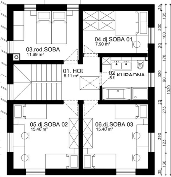

prm2021 schrieb:
This was the first version, [...] And I’m also not satisfied with the windows, I prefer the design from this morning, and forget about that silly trend with corner windows. Use partially lightweight partition walls on the upper floor so you can arrange the floor plan more flexibly.
Tolentino schrieb:
The child who behaved the worst always ends up there... I would do it differently: just two kids’ rooms, the larger one for two children, and the smaller one assigned each month to the child who behaved best (or by drawing lots). This way there’s one shared kids’ room and one single-child room.
xMisterDx schrieb:
Is this a joke? Two kids’ rooms with 16m² (172 sq ft) and one with 8m² (86 sq ft)? Yes, the architect was deliberately joking 🙂
He knew I didn’t want the parents’ bedroom on the south side and that I dislike balconies 🙂
Tolentino schrieb:
I was being ironic as well.
By the way, I know what I’m talking about because my man cave/home office is exactly 8 m² (86 sq ft). It fits a desk, a filing cabinet, a shelf, and a sofa bed. If I didn’t have a floor-to-ceiling window, which I plan to use in the medium term, a dresser could also fit in, and some shelves could go above the sofa bed. For me, it works (I also sleep here regularly), but for a child, that’s definitely not enough. Better to make one room larger and have two kids share it. That’s my opinion. I didn’t think I would accept 8 m² (86 sq ft) for this room 🙂
I will try to increase it to at least 11 square meters (118 sq ft) so that we can feel comfortable when the third child arrives.

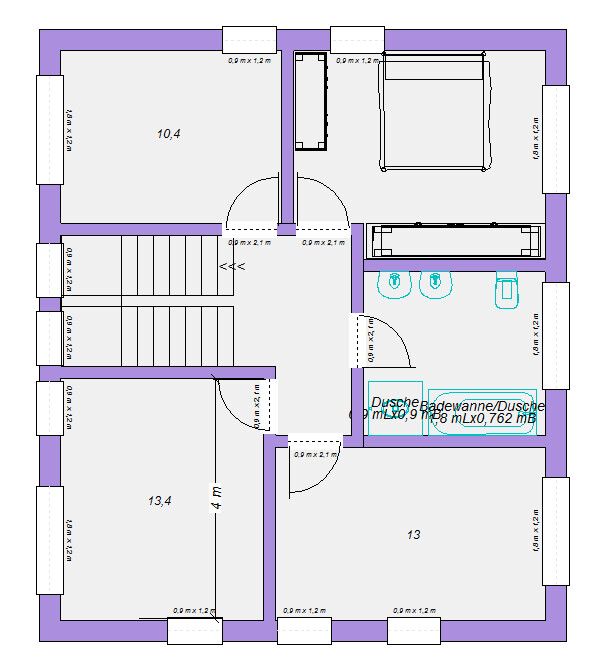

hanghaus202316 Jul 2023 20:20hanghaus2023 schrieb:
So you improved the children's room to 10.3 m² (111 sq ft).
Yes, but the bedroom is a bit of a disaster. If you manage to move the staircase just 10 cm (4 inches) upwards according to the plan and rotate the direction of the stairs, I would plan something like this:
3 m (10 feet) of closet space plus a chest of drawers—that should be doable in your own house.
K a t j a schrieb:
Yes, but the bedroom is quite a mess.
If you manage to shift the staircase just 10cm (4 inches) upwards according to the plan and change the direction of the stairs, I would plan something like this:
3m (10 feet) wardrobe space plus a chest of drawers – that should be possible in a detached house. Thanks, Katja, perfect!
Should we install double windows facing south in the children’s rooms? And smaller windows on the east and west sides?
I love big windows 🙂
