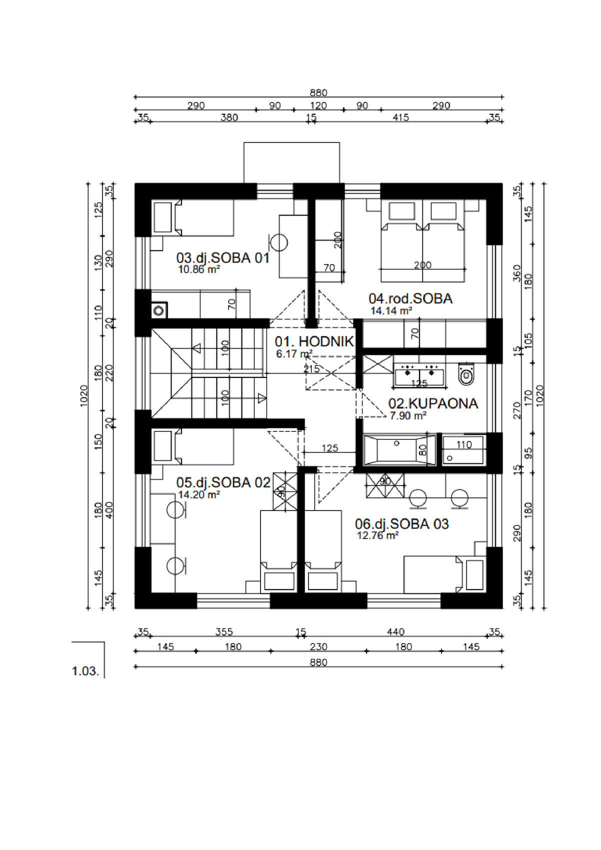

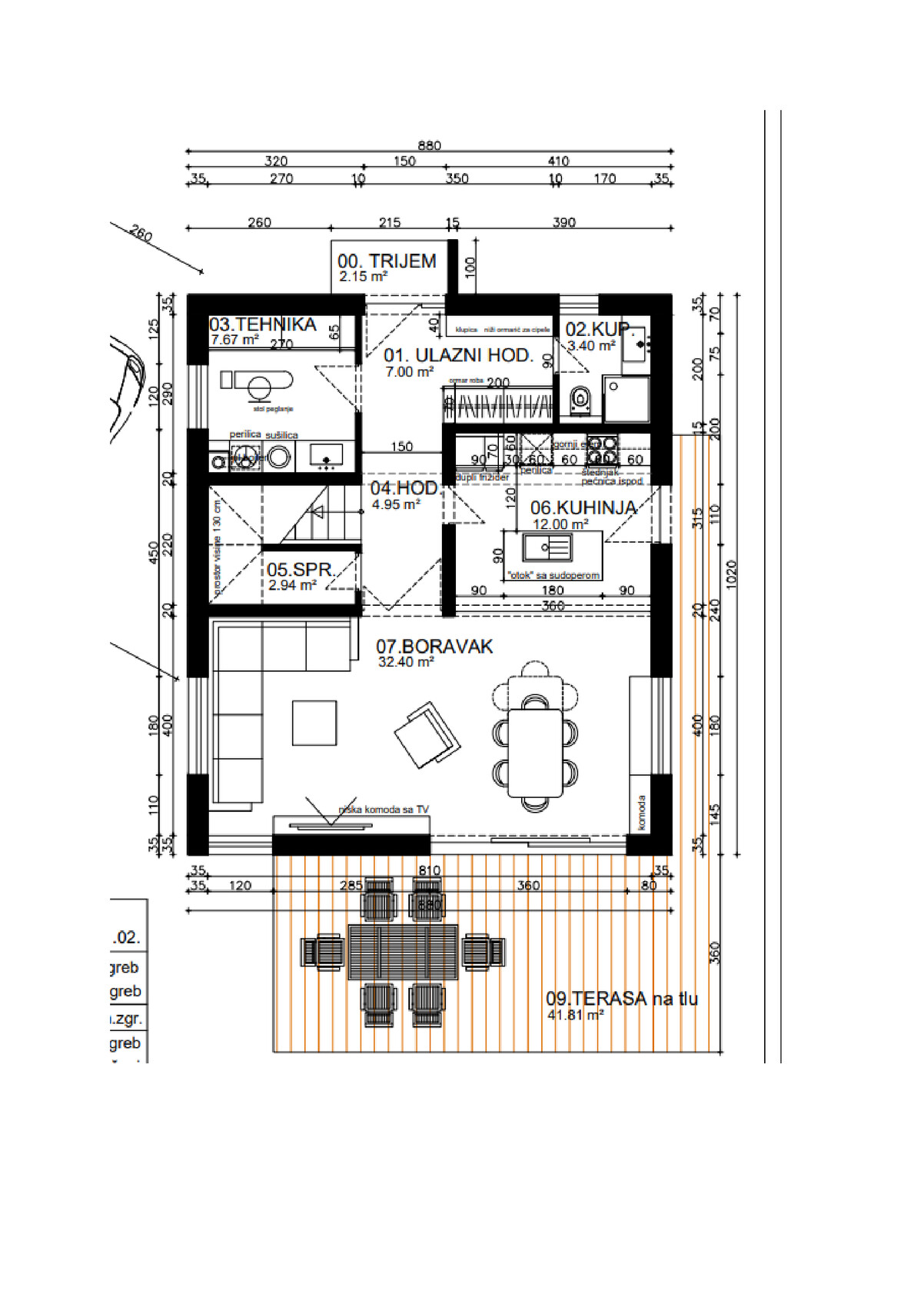

We are planning to build a house on a 600 m2 (approximately 6,460 sq ft) plot with a west-facing approach (a dead-end street). Unfortunately, the garage can only be located on the west side (as shown in the picture).
I will soon discuss the preliminary design with the architect. According to the regulations in my country, the original project cannot be changed later on.
According to the zoning plan, we must build an enclosed garage (2 parking spaces per dwelling, with 50% of them in an enclosed garage). This increases our construction costs, so we have to reduce the “ideal” size of 150 m2 (approximately 1,615 sq ft) by about 10-15 m2 (approximately 110-160 sq ft) and, of course, without a basement.
I have read many forums and found that the most important thing is that the living and dining rooms are not narrower than 4 meters (approximately 13 feet) and have at least 35 m2 (approximately 375 sq ft). We will spend 90% of our time there and in the kitchen.
We want an open kitchen facing east with as much natural light as possible (preferably in a two-row layout). We want the utility room to be at least 10 m2 (approximately 108 sq ft), the stairs to be as comfortable as possible without taking up too much space, and a guest toilet without a shower. In front of it, there would be a wardrobe (for an Ikea PAX depth 70 cm (27.5 inches)).
Upstairs, we would like natural light in the hallway, two children's rooms of about 13-14 m2 each (approximately 140-150 sq ft), facing south, and a bedroom facing northeast, where we need to place my wife’s Ikea PAX wardrobe measuring 200x70x240 cm (79x27.5x94 inches). In the bedroom, my wardrobe should also be placed, but it can be smaller than my wife’s.
I would like to build two full floors in a rectangular shape with a gabled roof, similar to Jaydee’s floor plan attached (of similar width and length), although her plan is not two full floors.
My wife would like two bathrooms or a guest WC with a shower. I’m assuring her that one bathroom with two sinks will be enough.
I apologize for my poor German. I have been following your forum for months and have learned a lot. Thank you for any help.

K a t j a schrieb:
I think the window is important. Otherwise, the upstairs hallway would be as dark as night.
For the closet in the bedroom, you’ve allocated 70cm (28 inches) with drywall. Most closets are 60cm (24 inches) deep, maybe one or two are 62cm (24.5 inches), but hardly any are 70cm (28 inches). In my opinion, there is a bit too little space in the bathroom. I would go for 65cm (26 inches). Or has your wife already chosen one? 😀 “The Pax closet with sliding doors is 66cm (26 inches) deep, and 60cm (24 inches) without.”
That’s what it says. Do you think 66cm (26 inches) is enough? There is a window in the upstairs hallway; the hallway downstairs doesn’t exist—shouldn’t there be one there, too?

K a t j a schrieb:
For the wardrobe in the bedroom, you’ve currently allocated 70cm (28 inches) with drywall construction. Most wardrobes are 60cm (24 inches) deep, maybe one or two are 62cm (24.5 inches), but hardly any are 70cm (28 inches). In my opinion, the space in the bathroom is a bit tight. I would go for 65cm (26 inches). Please, no more confusion now that the goal is so close. The centimetre-level discussion about wardrobe depth reminds me traumatically of Princess @Shiny86’s hallway closet ;-)
