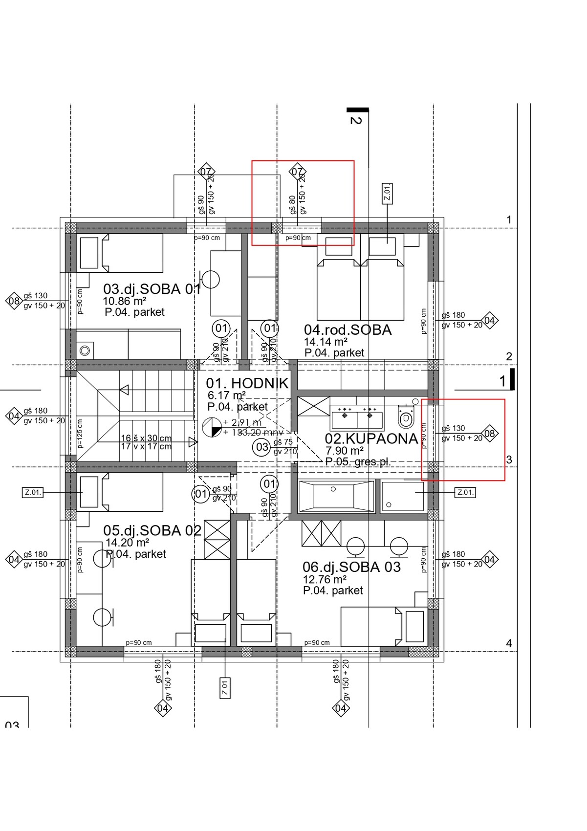

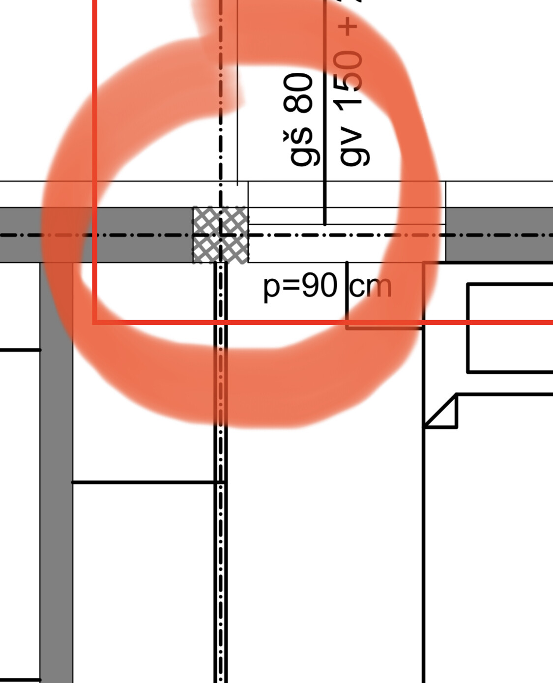

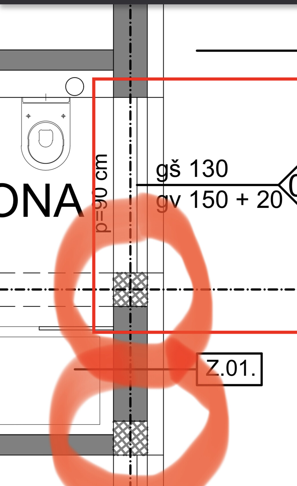

The structural engineer requires changes due to the reinforcement, and now we have to reduce the size of the windows in the bathroom and bedroom.
Alternatively, we could move the bed closer to a different window. The top side of the plan faces north and is near the neighboring house.
I would like to enlarge the window in the children’s room on the north side. Do you have any suggestions for the bedroom?

11ant10 Nov 2023 15:08
prm2021 schrieb:
The structural engineer is requesting changes due to the cerclage, and now we have to reduce the size of the windows in the bathroom and bedroom.
Or move the bed towards a different window.
What does a cerclage have to do with the structural integrity of a building, and how does moving a bed have the same structural effect as reducing the size of a window???

What does a cervical cerclage have to do with a building’s structural stability, and how is moving a bed structurally equivalent to reducing the size of a window???
You know what I was thinking, a vertical reinforced concrete element. Cerclage in Croatian. Regards
Technical floor plan with red circle around a node and dimension p=90 cm (35 inches)
Technical drawing with central axis, red rectangle and marked circles
