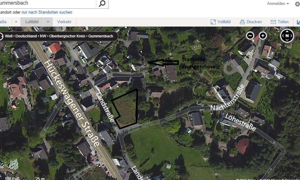

I came across the following plot of land.
After work, I will go to the town hall to clarify the exact building regulations.
[B]Area: approx. 1024 m² (11017 sq ft)
Zoning regulations:[/B] development plan 1 and 1a, general residential area, two-story, open building form, site coverage ratio: 0.4, floor area ratio: 0.7
Additional information: The plot is for sale. A contact address can be requested from the urban planning department at the Gummersbach town hall.

D.Gerner schrieb:§34 is certainly not the problem; the ups and downs in this area are more so. In this respect, your floor plan might be missing a basement 😉
We are currently looking for a suitable plot where development is regulated according to §34. It’s not exactly easy, but you can still find gap sites where it would be possible. We are from the Gummersbach district.
Regards, Bauexperte
