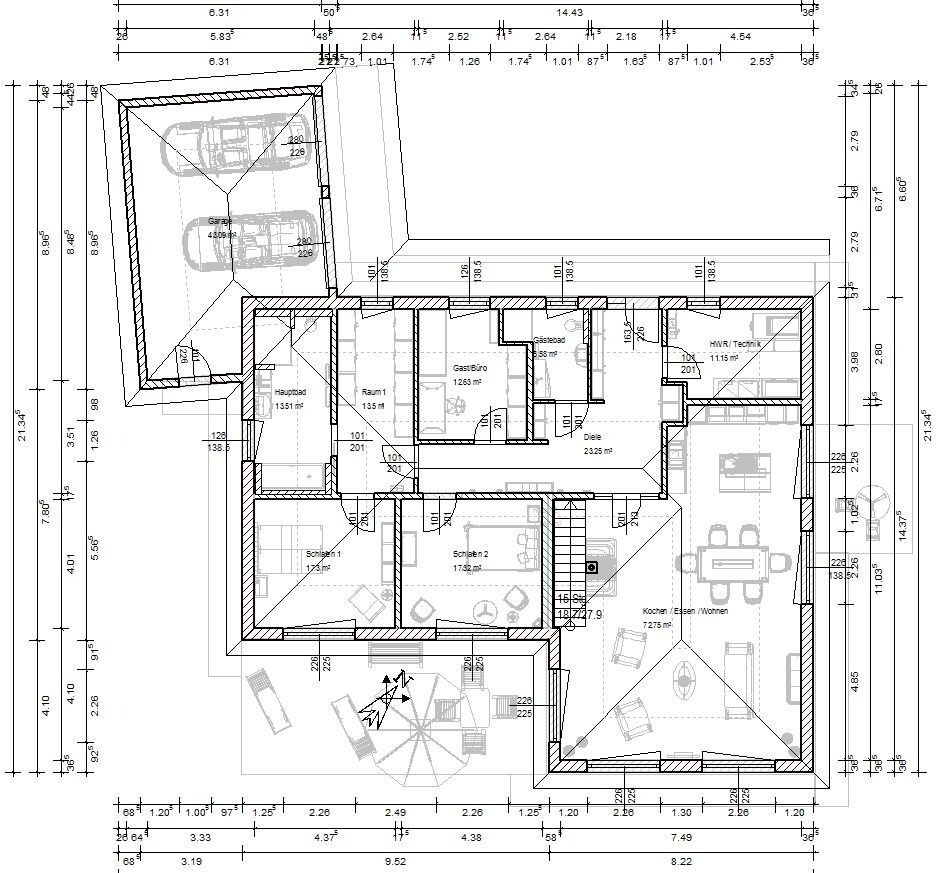

I have noticed that many members here share their building projects and experiences. I have already gathered a lot of ideas and had several “aha” moments thanks to this forum.
We are now at a stage in our planning where the design for our bungalow is finalized.
It would be great to get some assessments or opinions on the project.
Here are a few key details about the construction:
- The roof will be a hip roof
- Energy supply: gas and solar
- Underfloor heating
- Still undecided between siding or plaster for the exterior
- The guest room will mainly be used as an office but with a sleeping option
- The staircase in the living room will be a “floating” staircase leading to the attic. In front of the attic entrance, a space will be created for a desk with a PC. This way, you can look down into the living room from above, and the attic is somewhat “concealed.”
- The plot size is approximately 1,000 sq m (0.25 acres).
I hope my information is helpful. If you need any additional details, I will be happy to provide them.
I truly appreciate any support.
Architekten-Grundriss eines Einfamilienhauses (EG) mit Zimmern, Türen, Maßen, pinken Wänden.

Your last draft already had 186 sqm (2000 sq ft), at least if I add up the room sizes.
What does your mother expect to gain from access to the utility room through the garage, if the utility room is located so inconveniently within the house, as in your design?
The door to the bedroom wing can simply be moved to the left, flush with the wall between the dressing room and the guest room, and then that room is outside your parents’ private area.
Floor plan of a detached house with garage, rooms, kitchen, dining/living area, and utility room.
To see who is coming… your mother isn’t always in the kitchen. You can also get a view from the side terrace door, and otherwise you’re either sitting in the sofa corner, etc., or upstairs at the computer, so you wouldn’t have this view from the kitchen anyway. Also, the small terrace is naturally most enjoyable when accessed directly from the kitchen. However, since it’s not ideal for this terrace to be right at the upper corner of the property, moving the kitchen downwards in the plan makes a lot of sense.
And a room with an internal length of 14.3 m (47 feet) … with a ceiling height of 250 cm (8 ft), that can feel quite oppressive.

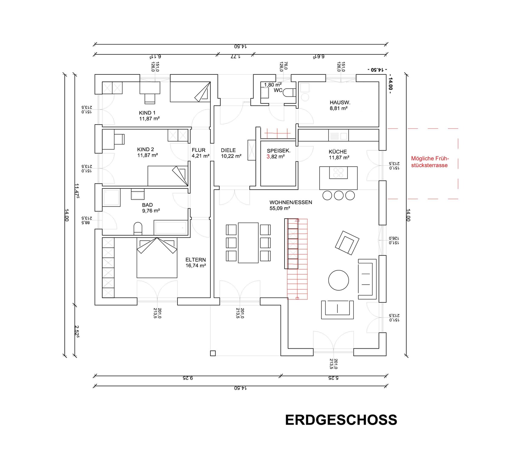

As an example of how it can be done smaller and more reasonable, I "borrowed" the documents of my partner and the attached draft and made some sketches. "Private" and "living" areas are separated, one bathroom is sufficient (the sanitary fixtures are just placeholders), and the design can be quite easily adapted to the needs of people with disabilities (which should be considered for aging). If an extra office on the gallery is really planned, this design offers the possibility to open the living area up to the rafters, place the office behind it, and use only the space above the private area as additional storage. I recommend designing the staircase open and using it as a centerpiece / room divider. Altogether, it will also be easier on your wallet.
Regards, Bauexperte
Ground floor plan: living/dining room, kitchen, pantry, bathroom, master and children’s bedrooms, hallway

@ypg, actually, I did expect that... Just kidding. Of course not. However, if you step away from some of the usual "it’s always been done this way" thinking and want to stick with the L-shaped bungalow, I find my solution quite practical.
I also don’t understand how @drathjen arrives at the idea that his design is only 160 sqm (1,722 sq ft).
In general, based on the site plan:
the L-shaped bungalow doesn’t seem like a bad choice. It would be interesting to know the height of the hall at the lower left corner. Given the figures, I would say the walls are as high as the bungalow including the roof. That calls for plenty of greenery along the property boundary.

But there is no walk-in closet included, and no access from the garage into the house either.

Not just maybe: the walk-in closet in the open corridor area from @kbt09 is much more spacious than a confined room. Especially if that area is just for the two of you. Your “child’s room at Mama’s hotel” could be relocated outside the main corridor. And the size of a living room is not just about square meters. Sometimes a different layout simply offers more.
