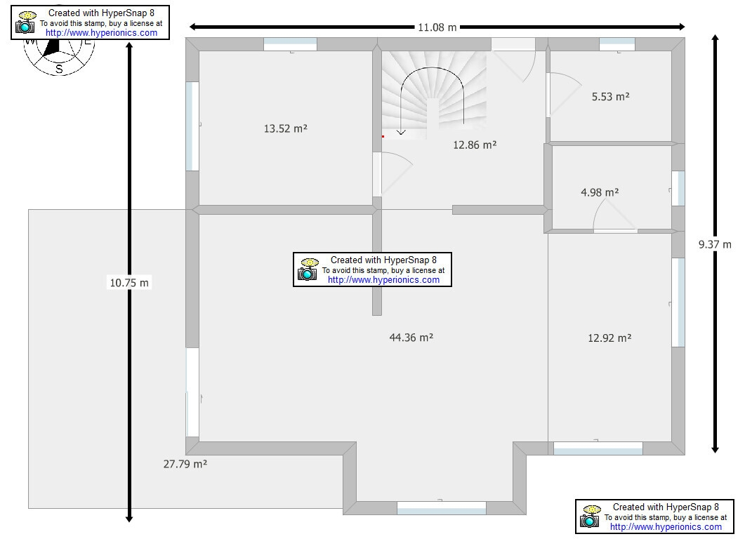

What are your general thoughts on the floor plans? Do you notice any major flaws? Would you leave the house orientation as it is or, for example, move the entrance to the east side?

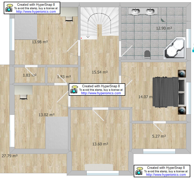

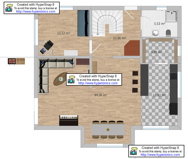

Häuslesbauerle29 Mar 2021 14:12Fits well, the furniture was included only as "placeholders," the focus is on the room layout.

That works, the furniture was added just as “placeholders,” the focus is on the space planning However, the space planning depends on the possible planned furnishing.
There are only 6 minutes between the post by @bra-tak and yours: are you sure you received and fully considered the objection?
I don’t find the design very appealing either: the grid is known from other plans, but for example the staircase is much too small, there is no space for a wardrobe, and instead an obstructive cabinet is placed there.
The bedroom only has a skylight above the bed and a cramped walk-in closet that hardly offers enough wardrobe space. The sofa placeholder suggests more space than actually exists. The kitchen has a rather narrow counter, too few cabinets to function well, and is again too wide for a galley layout.
I think the closets in the children’s rooms are well designed. That’s great!
Under these conditions, it is essential to have an architect involved in the planning!
