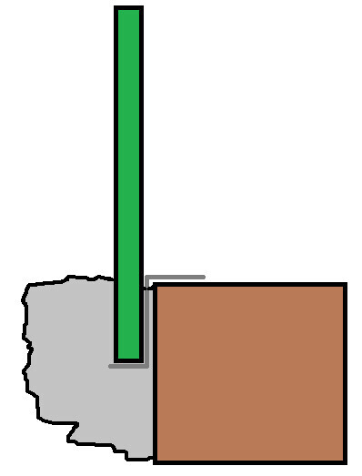

Would it be possible to secure the post to the stone at height using L- or S-brackets and then encase it in concrete, so that we basically go back to the previous option (embedding it behind the wall) — only this way the post couldn’t sink? Or would frost still push it out / could it still sink like that?
Viewed from the side like this:

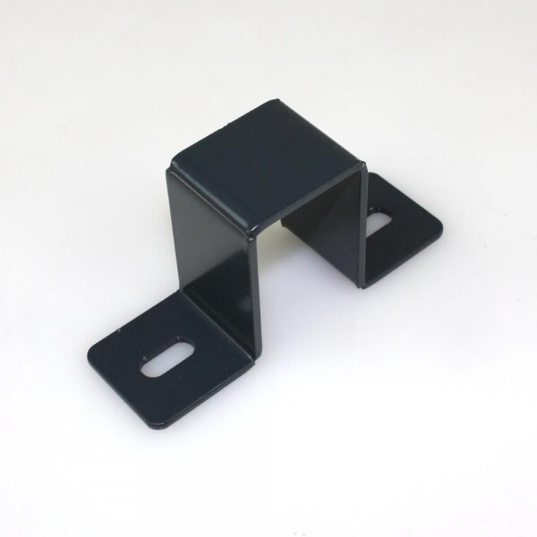

// Edit: I spoke again with the landscaper. He suggests: Two clamps per post, and additionally securing the lower part of the post with a screw through clamp/post/stone. If needed, add a bit of concrete around it as I suggested above. Apparently, that’s fully sufficient, with reasonable cost and effort. Sounds like a plan!
Changeling schrieb:
He means: two clamps per post, and additionally fix the lower post with a screw through clamp/post/stone. If necessary, add some concrete around it. It's not about just securing it! The point is that all posts are aligned.
How do you screw your clamp/bracket onto a "crooked" stone?
