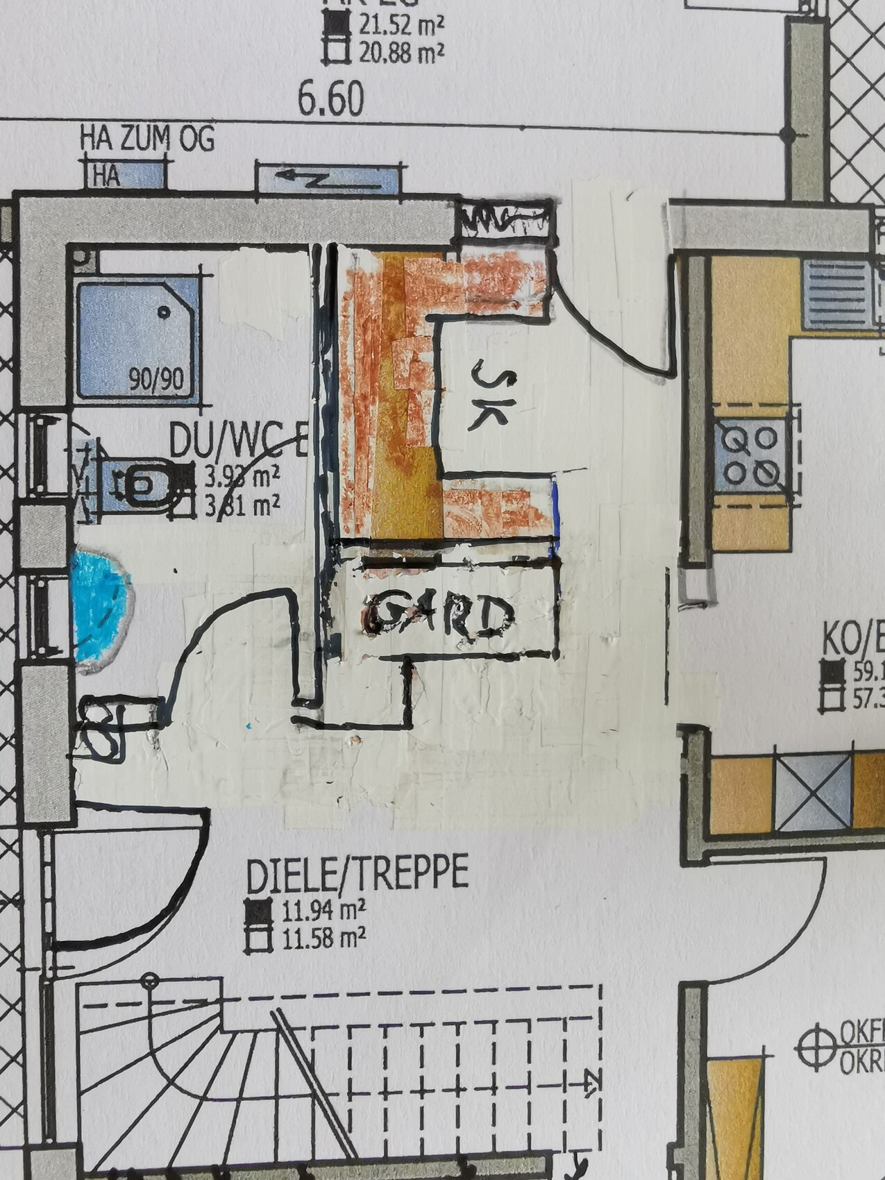

*Sterntaler*7 Jun 2021 18:14B
Bertram1007 Jun 2021 18:18Is SK the pantry? Do you even need one? With a spacious kitchen, you can store a lot. I wouldn’t want the cloakroom “back there.” When you come home with all your stuff, I think it’s great to be able to drop everything right behind the door. The dirt stays there, too.
The cloakroom shown is really tight for three people with different coats and shoes. I would probably swap the pantry and the cloakroom.
