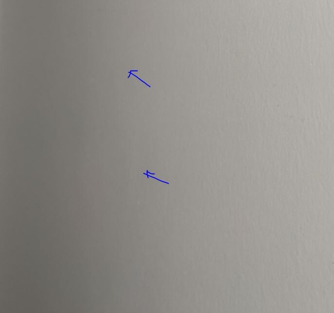

Ok, thanks. Maybe what I’m doing isn’t so bad after all. In real life, I notice it immediately, but in photos it’s barely visible. Only in 1 out of 4 pictures can you see it:
But don’t get me wrong, the dark edge on the left is due to low lighting; the paint color is a nice white everywhere. However, where the arrows point, you can see slightly lighter patches from the new paint. In the picture, I repainted about one-third of the surface in the middle, and you can see the transition there.
By the way, this is the basement where I made my first attempts before moving on to the other floors. 😉
