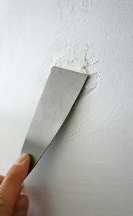

The wooden rocket built by hand was launched in the living room and shortly afterward, the wall looked like this due to a rough landing...
I can’t call a painter every time something like this happens or repaint the entire wall. And with kids at home during the pandemic, I can’t always scold them when accidents happen. That’s why I prefer to regularly do touch-ups and keep everything in top condition.
