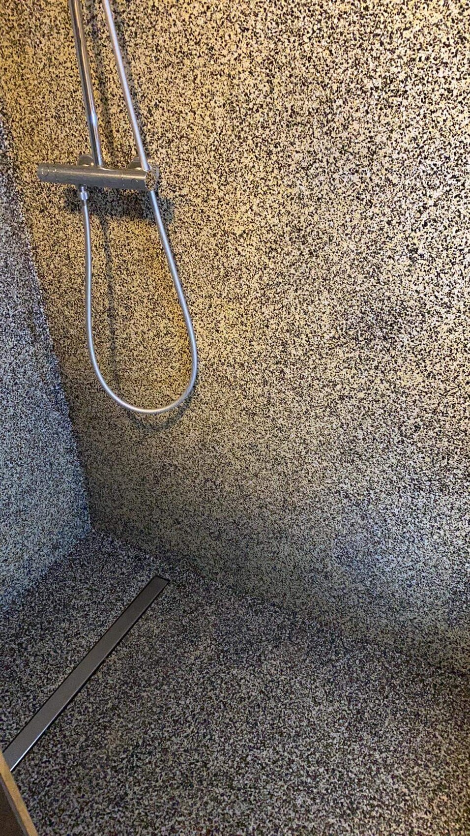

This is what a seamless shower looks like
Shower with handheld showerhead and hose on holder, terrazzo-style wall and floor, visible drain.

2 Feb 2020 11:50
Phew, are there any that look nice as well? ops:
