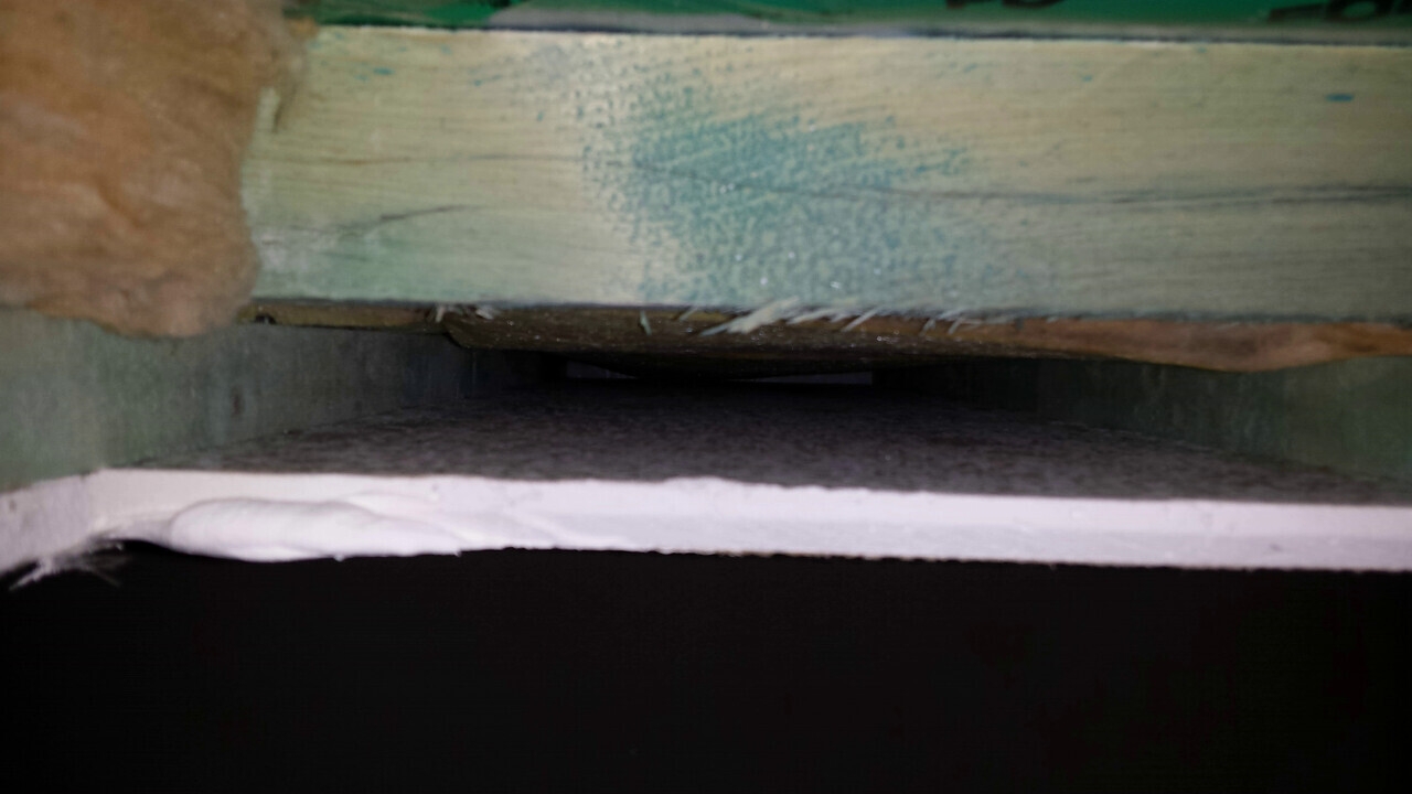

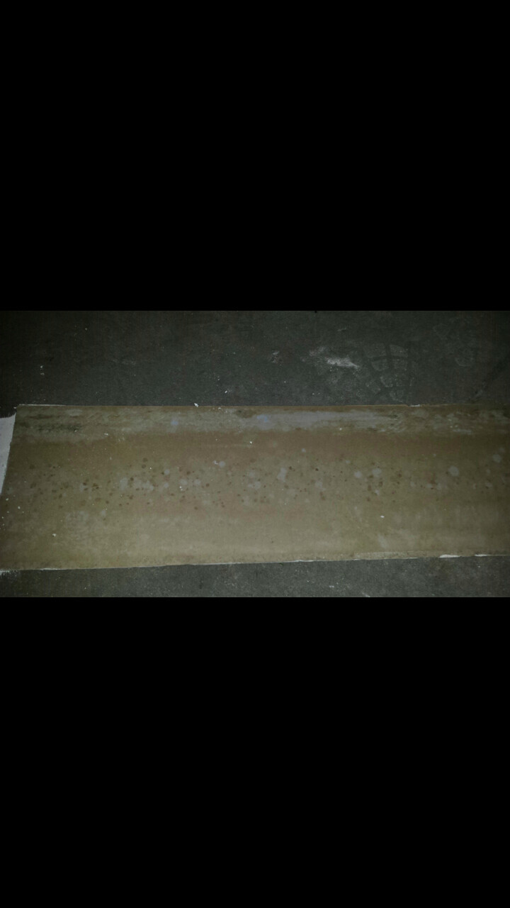

small update, I removed a small panel and, as expected, it is actually much more severely affected than the front side. I only took down a slightly damaged one. I also found a gap at the roof hatch where I was able to take a picture through.
View of ceiling beams with insulation, open gap and signs of construction defects
Long brown panel lying on dark construction site floor, indicating shell construction and foundation
